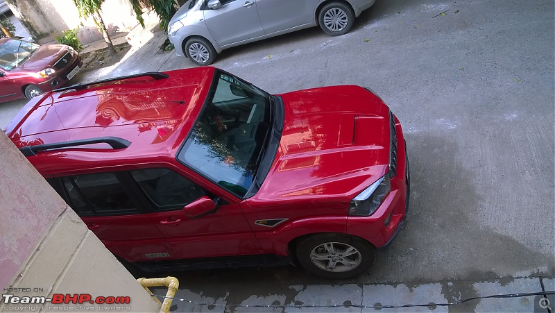

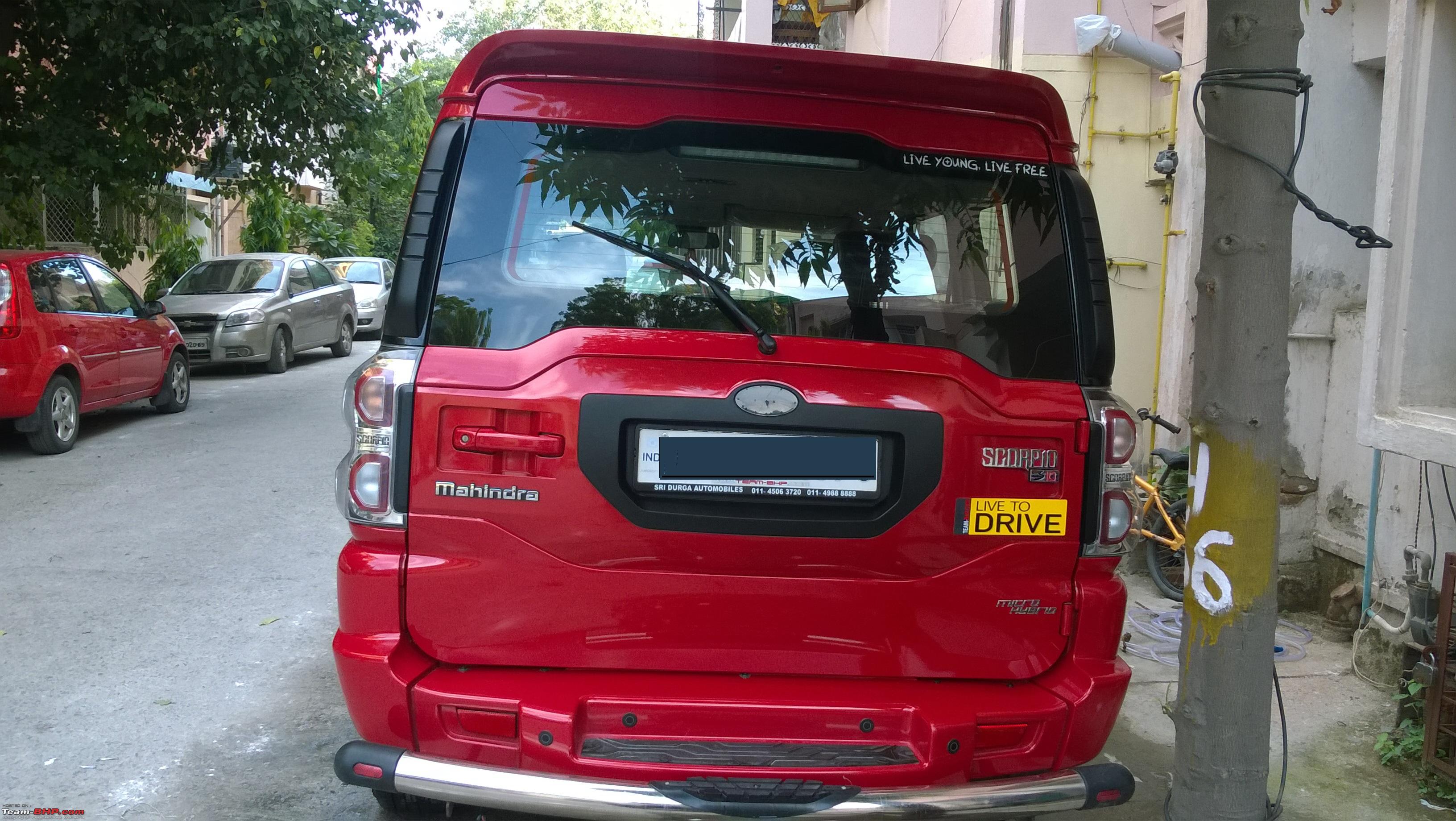

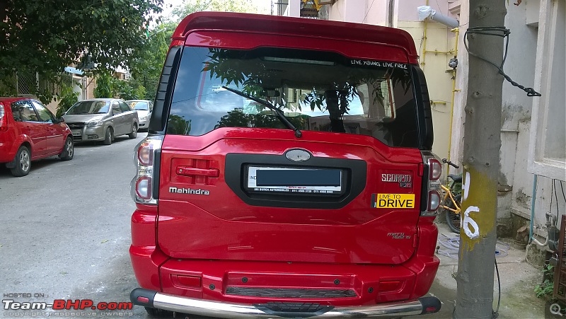

I would also like to share my experience with all of you from this Sunday when I detailed my red Scorpio. It was way too much work and my whole body is aching as of today lol: . But the best thing is when my wife came back from market and said 'How come the car is shining so much today' really helped me to forget all pain. The process is explained below:
Interior detailing:
1. Used Bergmann Hurricane car vacuum cleaner
2. Collin for internal plastics
3. All purpose Microfibers (260 GSM type)
Exterior detailing:
My idea was not to remove any swirl marks. I still get happy when I see the real molten red of my car. Every thing was done with hands and no machines involved.
1. Rinsing with plain water
2. Used Meguiars NXT shampoo
3. Again rinsed with water and post this sprayed ONR through out
4. Used Meguiars water magnet for drying (is an amazing product)
5. Used Optimum opti clay towel for claying and ONR as clay lube
6. Used Wolfgang deep gloss paint sealnet
7. UPGP applicator pad for step 6. I like this one because it is a big rectangular block that is easy to hold and use.
8. Microfiber 530 GSM for buffing + Meguiars supreme shine for claying
9. Aerospace 303 for plastics and trims
10. 3M glass cleaner
I'll leave pictures for all of you to decide about the end results. But I committed many mistakes in the last step. Like for example I buffed Wolfgang a little early and did not wait for 30-35 minutes as recommended by manufacturer. On some portions where I delayed buffing, the results were better.
My big mistake of the day was to go for complete cleaning [interior + exterior ] in a single day. It was way too much work and still there were many things that were left. Also, the fatigue impacts your last crucial steps like what I reported above.
Another big mistake was to rely on vacuum cleaner for internal cleaning. Though I read mixed reviews about these products on different sites but still went for this purchase during big Amazon sale some days back. The product has 'ok' type suction power and heats up very quickly. Just in 30 minutes it became so hot and fuse went off. I think brushes will be more effective in the long run.
I still lack some tools for proper cleaning.
  1. For example I need a good brush for tyres and sidewalls.
  2. I need a brush for interior areas like AC vents etc
  3. I need a brush to clean front honey comb plastic grills.
  4. A much needed All purpose cleaner (APC) already suggested by blackasta
  5. A tar remover for alloys or may be APC helps here.
  6. Any tool with soft microfiber on one end and a long rod for cleaning the top of the Scorpio. Currently it is a pain in the neck to clean it.
And finally one last word for Wolfgang sealant. This looks like an amazing product as it provided an amazing shine with very little effort and even when I did not follow the right process. I am not sure what magic it can bring with a machine polisher and following manufacturer's recommendations. The only drawback with this one is its price. Currently in Indian market it is sold for close to INR 4000. But I got mine from US gifted by a friend. I'll think twice or thrice before spending this much on buying a single product.
Finally few pics post all work:
A superb Car cleaning, polishing & detailing guide-wp_20160821_17_03_31_pro.jpg
A superb Car cleaning, polishing & detailing guide-wp_20160821_17_34_01_pro.jpg
A superb Car cleaning, polishing & detailing guide-wp_20160821_17_34_22_pro.jpg
A superb Car cleaning, polishing & detailing guide-wp_20160821_17_39_13_new.jpg
A superb Car cleaning, polishing & detailing guide-wp_20160821_17_34_56_pro.jpg
