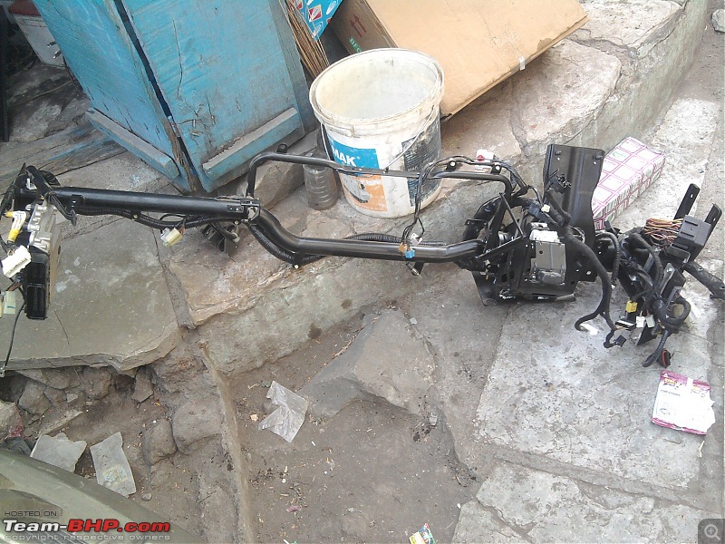

Below are the details of the job--
1) After removing complete dashboard and all inside parts--
A/c Evaporator coil fails 2nd time in my Ford Fiesta-after-removal-dashboard.jpg

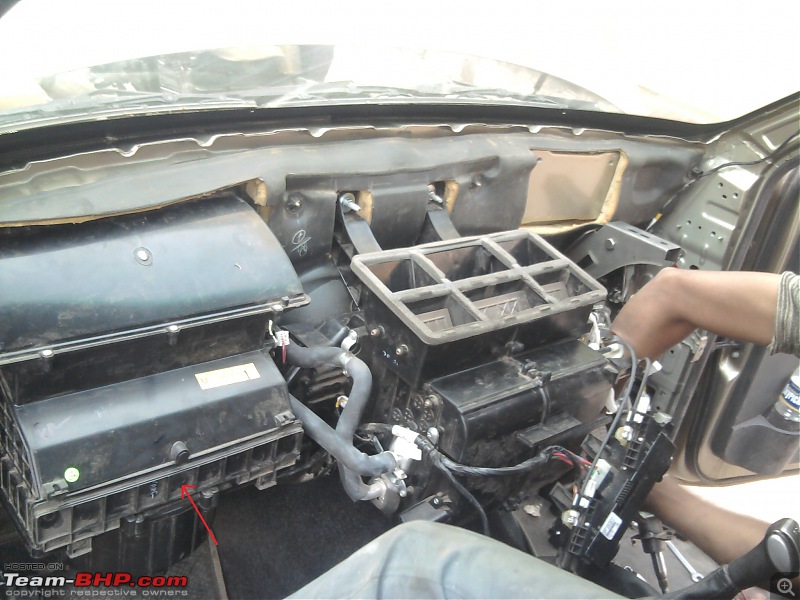

4) The AC Cabin Filter and Blower Housing--
Red Arrow shows Slot of Cabin Filter and Green Arrow shows the Blower Housing
A/c Evaporator coil fails 2nd time in my Ford Fiesta-blower-ac-cabin-filter-housing.jpg

6) The Fitting Process going on--
Here too the Cabin Filter is visible (Red Arrow). Below it is the Blower Housing.
A/c Evaporator coil fails 2nd time in my Ford Fiesta-fitting-ac-unit-2-location-cabin-filter-visible.jpg
A/c Evaporator coil fails 2nd time in my Ford Fiesta-09location-cabin-filter.jpg
