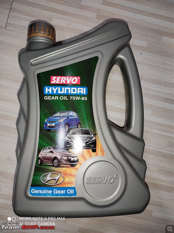

My SX4 Zxi (Manual Transmission) of 2011 has completed around 1,26,000 km.
At 80,000 km, I had changed the gearbox oil. That time, I could not find 75W90 or 75W85, the oils recommended by MSIL. The closest I could find was 80W90, which I purchased and poured into the gearbox. But after switching to 80W90, I felt that the gearshifts were less smooth than earlier. I felt as if my gearbox isn’t like it was before.
80W90 has completed 46,000 km now.
Today I again searched for 75W90. After spending hours searching for it, I had two choices. 75W90 synthetic from Volvoline and 75W85 mineral oil from Servo (Indian Oil). Went ahead with 75W85 from Servo, which costed me Rs. 750 including GST for a can of 2.5 lit. I will change the oil tomorrow and give you a feedback.
Here are the pictures:
Rahul Bhalgat is offline
Old 20th November 2020, 15:45   #176
Posts: 1,188
Thanked: 1,998 Times
Re: How often should we change gear oil?
Changed from 80W90 to 75W85 oil.
The oil was bit dark after working for around 46,000 km and not smelling burnt. But still, after looking at the oil, I felt that I shall have changed the oil earlier. If I take the oil on my finger, it still appeared to be clean and of the golden yellow color. But when I observe the drained oil in the pan, it was dark blackish green with yellowish tinge at the walls of the pan. Next time, I am planning to change in 20,000 km, which is the recommended oil change interval. Rs. 750 for the oil and Rs. 200 for the oil change is not costly at all.
As I had said earlier, the gear shifts were not as good as they used to be from the first minute after changing to 80W90 in past. But with this 75W85 oil, I could notice smoother shifts on the stick.
