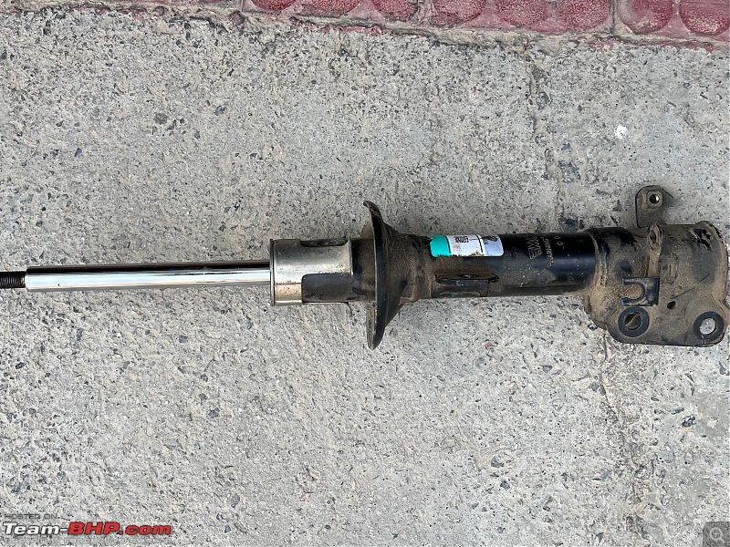

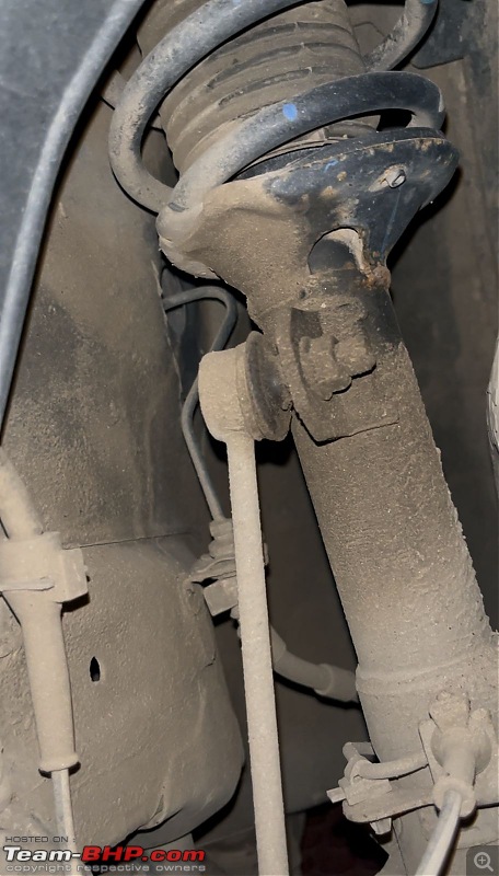

I have already bought a pair of Maruti Genuine Lower Arms and Shock Absorbers because as seen in the pictures, the shocks are leaking and are a bit on harder side now.

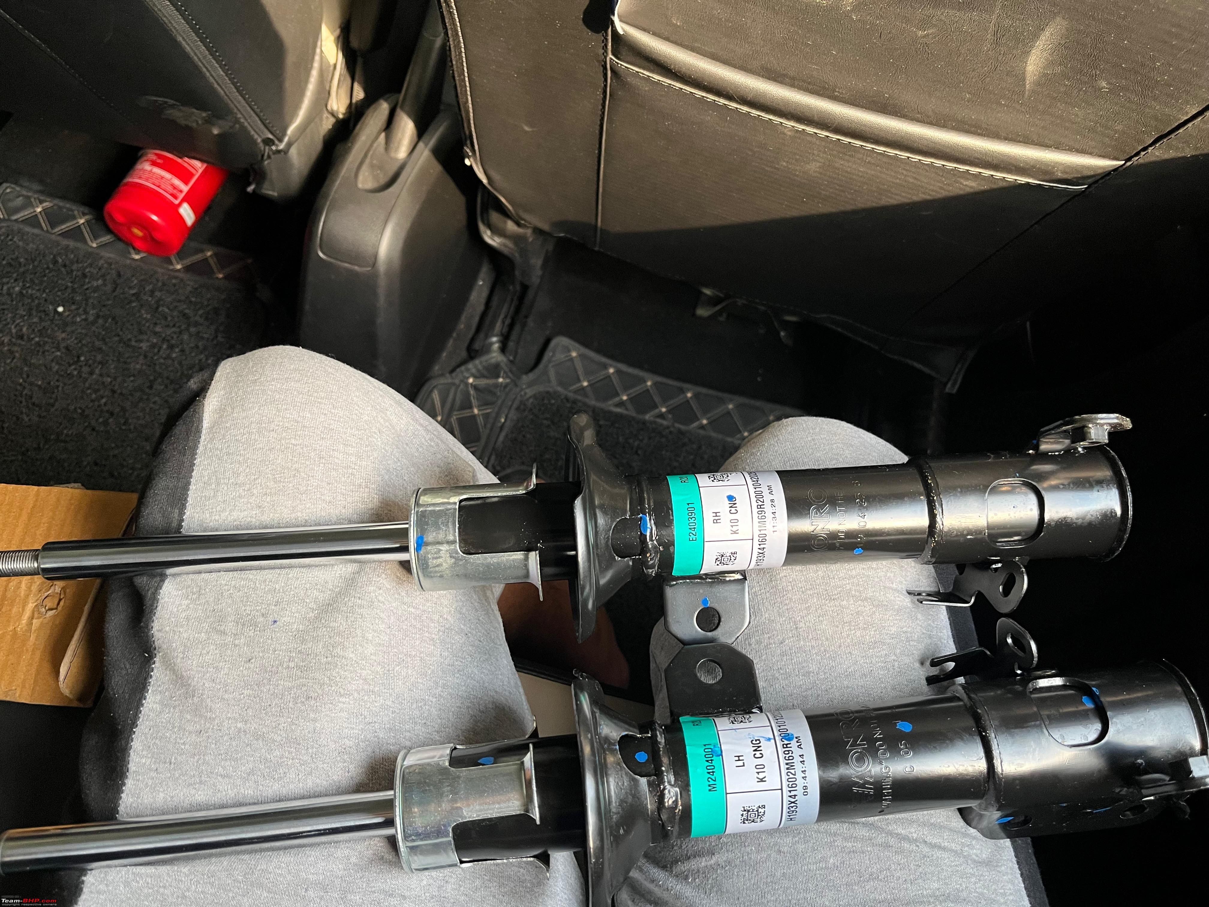

Just Have a look at the parts purchased.
I have got both the Lower Arms(L & R), Struts(L & R) and both the Shocker Mounts.

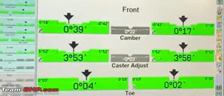

Talking about the alignment part, the alignment figures of the car are now in the accurate limits!
Both Camber and Caster are now restored to their factory settings.
Also talking about the ride and feel of the car, the steering accuracy has improved a lot and the steering re-centering has been restored now.

Alignment Figures :

NOTE : The Black-Circled part is the bent area
Struts :
