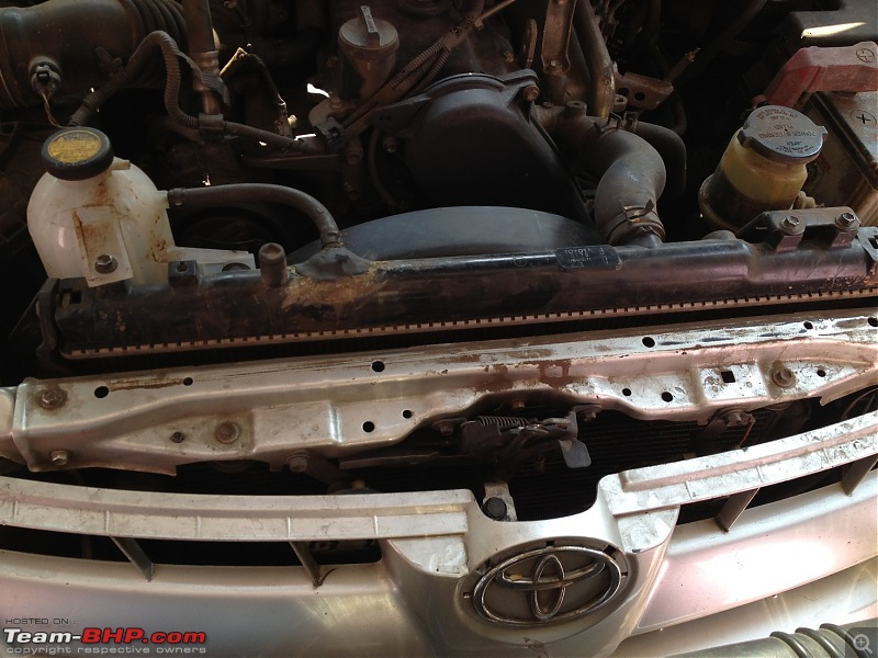

Here's incidence happened in my recent visit to native place (Sawantwadi). I was driving Mumbai-Kolhapur-Gaganbavda-Sawantwadi-Goa route with night stay at Kolhapur.On day II, when I started from Kolhapur to Sawantwadi, while descending ghat section my brother's Innova (2005) temperature gauge started pointing in red zone. I Pulled over at safe zone to check the problem. After opening the bonet, I discovered steam coming form leakage at the joint on overflow hose connecting upper tank. Water level was well below 'LOW' mark. I waited till engine was cooled down and checked the hose connection. Joint was broken and was leaking steam/Hot water through it.
After engine was cooled down, I topped up radiator with water and started the car to search for nearest garage. First garage spotted was tractors engine repair shop and I Pulled over. After looking at the situation, he advised me to block the upper tank overflow outlet with mseal and let it go
It sounded so stupid and I escaped from there and reached another mechanic 15 kms away. he's given 'Jugaad' solution so that I can drive to bigger city where I can find Toyota Dealership/service station.
Steps:
1) Let engine to cooled down
2) Cut off damaged section of the hose.
3) chopped off broken half of Overflow outlet.
4) Placed small metallic hollow cylindrical piece of tube at outlet and Joined it together with hose pipe.
5) Covered this Jugaad assembly (hose+metal piece+overflow outlet) with mseal to make joint.
6) Topped up radiator with coolant.
With this quick fix, I managed to return to Mumbai. Now I want to fix this problem and I have figured out two alternatives
1) Source Upper head of the radiator from Junk market and fix.
2) Get Genuine spares (comes with radiator upper tank and hose assembly).
The car is normally driven in city (monthly 800-1000 kms) and rarely taken out for long drive. Replacing radiator will cost more than 10k and I'm not willing to spend that much unless its necessary. Please advice should I go with genuine spare or source it from Junk market.
Regardless of where you drive i.e city or hwy I'd strongly recommend replacing the radiator assembly. There are higher chances of overheating in the city with bumper to bumper/stop and go traffic.
The jugaad joint is not going to last forever as it has corroded. You really dont want to take a risk with an engine seizure just to save Rs 10K!
Go with the genuine radiator assembly and make sure you only add Toyota's recommended coolant as a refill and for top ups.
