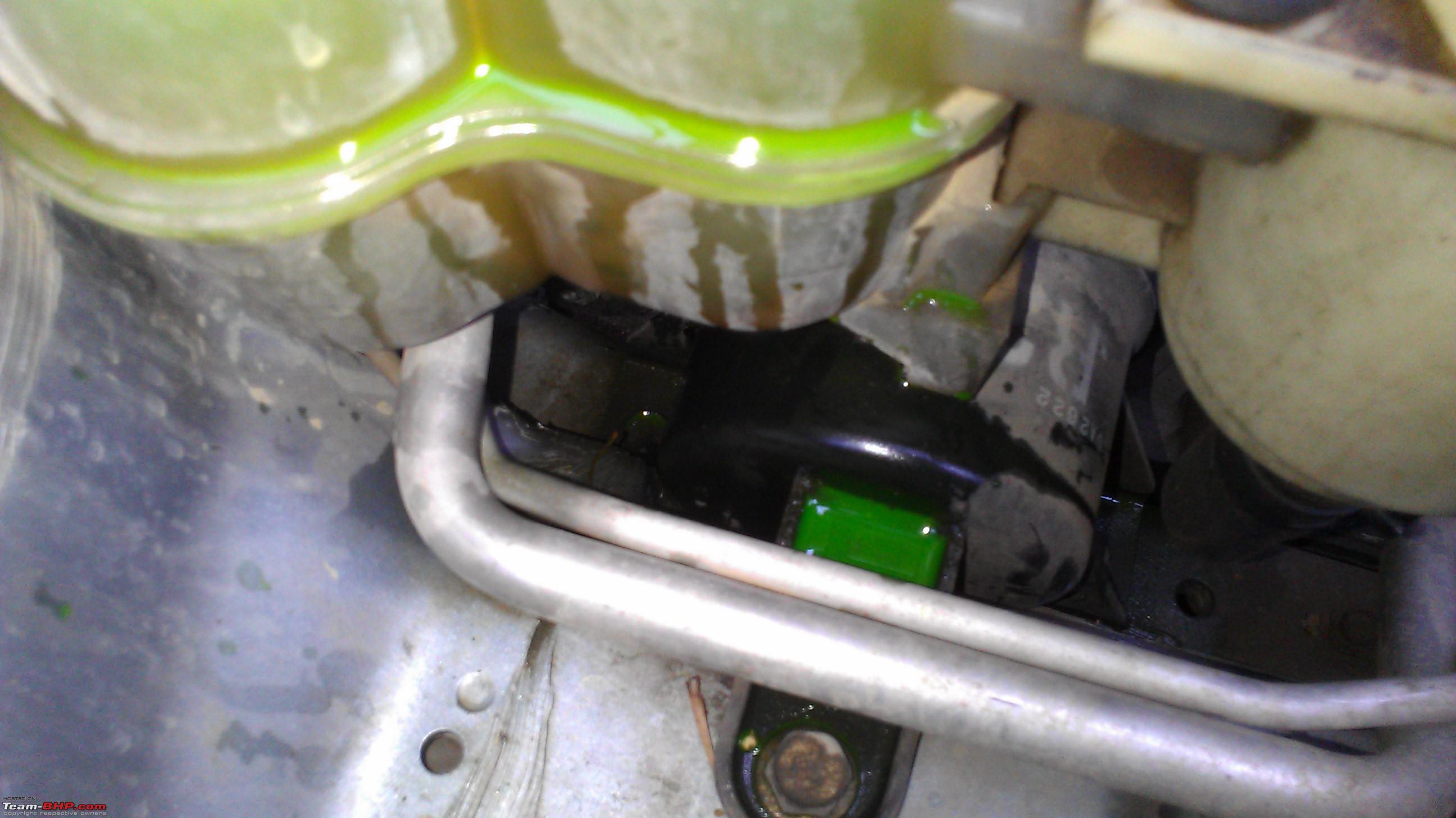

I have had very terrible experience with my Palio. I was driving with my family from Nainital. It was night and I did not notice that engine had overheated. The car stalled on the highway and we sought police's help to get it towed till Delhi.
I believed the gaskets were gone and after a poor ASS experience, finally sold the car in next couple of days!
bhardwhu is offline

Originally Posted by humyum View Post
A leaking hose pipe is what they mean. Happens, not to worry. You already had signs of a leak in the system when you saw a pool of water below your car once, should not have ignored it the, but never mind, what's done is done, be careful next time.
The engine oil replacement part is a good initiative by the service station
Oil pressure has got nothing to do with the cooling system, nothing at all.
Ask them to do a compression test and give you the results, that will be a 100% sign of if anything has been damaged or not. A good compression in all cylinders = nothing to worry at all.
Do post the compression results too here, we can look if anything is wrong or not.
Don't worry too much, I am 99% sure, nothing has taken a hit in you car, the 1% doubt will be cleared by the compression test result.
Hi humyum,
I got my car couple of days back. It took them 23 days for fixing
the car. They say that it took hard time to get water pump from Chevrolet dealers, which they say is general case with GM. Is it true ? They don't give chevy parts that easily. Meanwhile the garage was Carnation (Chembur) where I had given my car.
This is what they replaced to fix the 2 issues I had:
1) Water Pump (to fix Engine Overheating). There was a leakage in water pump, which resulted in car overheating.
2) Oil Pressure Switch (to fix Oil Pressure warning).
3) Coolant.
The car is running fine, as I drove around 40kms. No issues till now. They had earlier promised to change engine oil as well ... but when I took delivery they informed that oil is fine hence no change needed. I don't trust them because since all repair was done under warranty, they may have not replaced the engine oil to save cost.
Also, as per your suggestion I asked them to do a compression test on engine to access if any damage done to engine. But since it was weekend rush they refused. And said that all is fine with engine.
This weekend I am planning to do a compression test on engine with some other garage and also check if engine oil needs to be changed.
Can anyone suggest me a good place in Mumbai where I can have this test done ? I stay in Kandivali (Mumbai) any good garage nearby ?
Will post the compression results as soon as I have it.
Thanks

Well, the water pump taking it's time to come from Chevrolet might or might not be the case, but 23 days for one is too long me thinks for a car like the beat which has sold in good numbers. None the less, let's give them the benefit of doubt on this one.
Yes like i had told you in the first post, oil pressure switch will fix it. You are fine on this one.
Coolant replacement is fine, it had leaked out.
Engine oil should have ideally been replaced, if you don't mind, schedule one more appointment with them and get the engine oil/oil filter changed and a compression test done.
Drive the car around for some days and monitor the pickup and mileage. Fill up a full tank and after 200 kilometers or so, fill it up again and see what figures you get and are they similar to what they were before the fiasco.
Don't worry, as you say everything looks fine, it 99.99% must be.

Dear GTO, Humyum
Bad news ... after the water pump replacement, my Car again broke down yesterday ... after working fine for a month (Though short trips ... no long ones).
I was driving the car yesterday, it was afternoon ... extremely hot weather right now in Mumbai as you also know. I was stuck in traffic at Dindhoshi flyover near Oberoi Mall (Repair work in progress). It was just 4kms drive & my AC was on full setting. Suddenly the Car AC stopped giving cool air. The same symptom when water pump had failed last month. This time I immediately stopped the car, and open the bonnet without driving it furthur. To my surprise the coolant was all over the place around the coolant container. (See Attached Pics). And the car appeared hot.
I kept the car idle, called up the 'Carnation Chembur'. They arranged a mechanic from Borivali. After waiting an hour for him, he finally came. By that time engine had cooled off. He said it could be the fan issue ... which he wanted to test both when engine is cool & hot. Since engine had cooled off ... he first tested the fan. It ran fine ...
Then, he put some water into Coolant reservoir. He started the engine, with AC on ... cool air started from vents. Asked me to drove the car, so that engine starts heating up. We drove for about a km without AC ... then he turned on the AC. No cool air again ... so after about 2 kms drive we parked the car on the side. He opened the bonnet ... by that time we could see coolant bubbling inside the coolant tank. He checked the FAN ... it was running.
So, he ruled out FAN issue and told me it appears to be HEAD GASKET problem. He spoke with Carnation Chembur office, and it was decided to take back the car again to Chembur
After engine cooled off ... he made FAN to run direct. He dropped me off at home which was nearby ... about 2 kms more. And finally filled lots of water bottles that would help him take the car back safely to Chembur. Car reached their safely ... he made stops at regular intervals checking water.
So, with what happened yesterday I think GTO is correct ... something has gone with the engine for sure. But my question is why the car ran fine for last 30 days ? There was no issue with pickup ... no noise from engine bay ... it ran perfect with AC on.
If it is indeed HEAD GASKET ... how serious is the issue?
I bought the car on March 04 ... and till now 2 serious issue 'Water Pump' & 'Head Gasket'. And for water pump they took exactly a month to replace. One more thing, while my car was at their Chembur office for water pump replacement ... they broke the car rear tail light. It's been a month ... still not in STOCK. Called up 30 times ... same answer.

I think your cooling fan conked off & that's why the coolant ran dry.
Even if the workshop somehow gets your car up & running for now, I'm afraid that your engine could have suffered permanent long-term damage.
