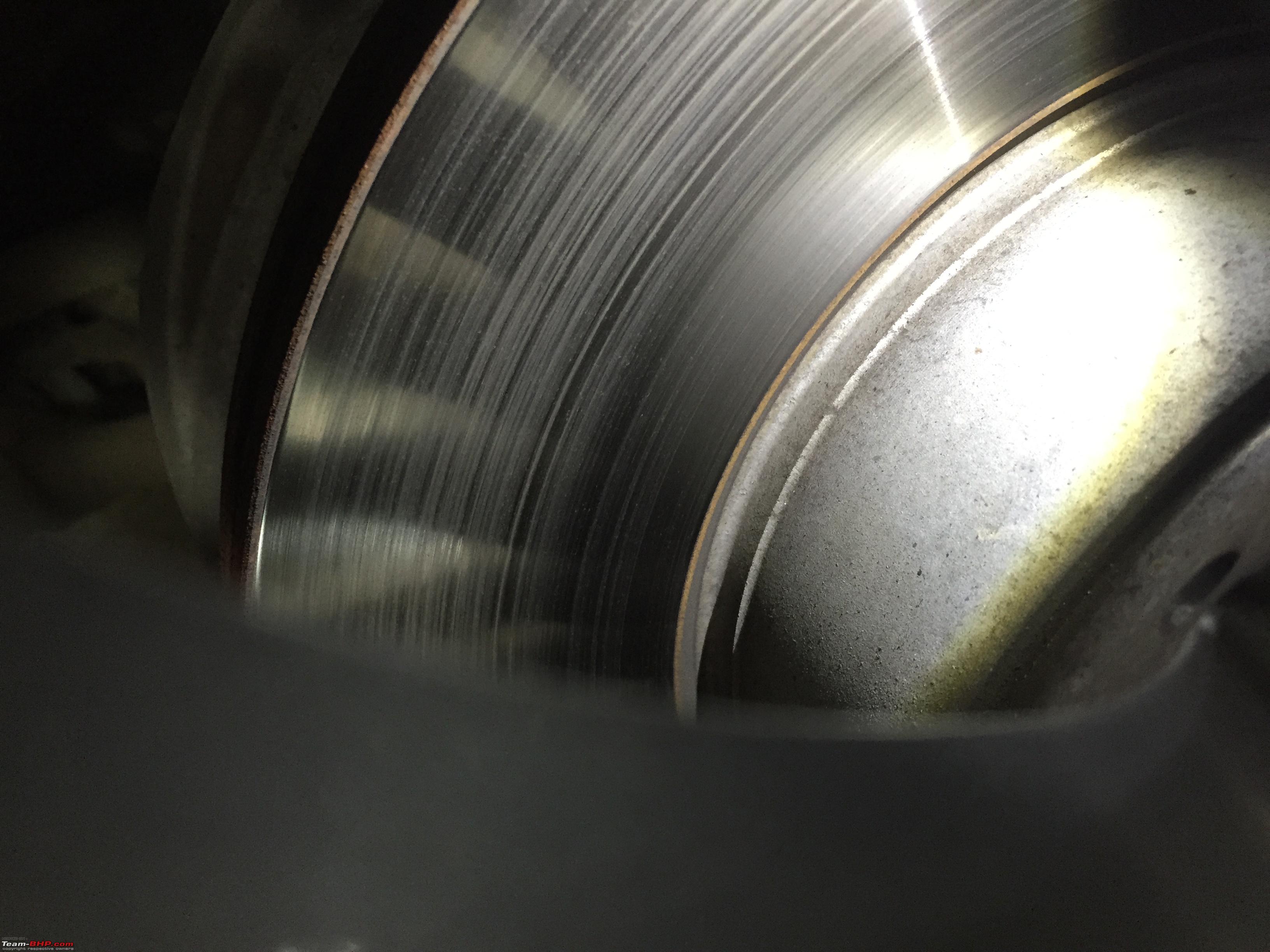

Hello Guys, Need your advice. please:
My BMW 3 GT has clocked 8000 km in 16 months. Yesterday took her for a 200 km highway trip (self was away from home & drove the car after 5 long months). Car is used weekly by my family & driver both in the city & on highway. Hence you can say car is not kept idle for a long time. My driver did not feel anything before. :eek:
iDrive car brake status shows brake pad renewal after, Rear = 32,000 km & Front = 36,000 km.
While mild / hard braking on speed above 75 km/hr, noticed whole car is vibrating or shaking. I can feel the vibration is in fwd-aft direction or in the direction of travel. Very light vibration is transmitted to steering & brake pedal as well, but overall car vibration is more. Braking performance remains good as always.
Today morning tried to inspect the brake disk with great difficulty (due to the alloy design), but got confused altogether. Please see photos below for front & rear brakes. There is a significant gap between the pad & disk at front. But rear brake pads are too close to the disk (or may be touching at the corner). If you see rear photos closely, you will notice the rear brake pad looks little tilted compared to front pads. Rear disk is smaller than front disk. Hand brake was NOT on. Have started the engine & pressed the brake pedal few times, no change in position.
What may be the problem ? Premature worn-out of pads ? or uneven disk surface ? Did not notice any deep grove or scratch on the disk.
Kindly advice if you have any experience on above problem. I don’t want to contact BMW prior I am sure about the real problem.
Sorry for the poor photos. Don’t be confused by the shadow on brake disk, those are from alloy wheel design.

REAR BRAKE = look closely the position of pad & disk
"My Car / Steering / Brake Vibrates While Driving" | What To Do-img_2826.jpg"My Car / Steering / Brake Vibrates While Driving" | What To Do-img_2823.jpg"My Car / Steering / Brake Vibrates While Driving" | What To Do-img_2824.jpg
Based on these symptoms I would say you have a warped brake disc. Most likely at the rear, if it was the front the vibration would be very (more) pronounced coming through the steering wheel.
You have to take the wheel of and check the rotor with a micrometer. A run out of as a little of 0.05mm is enough to cause (very) noticable vibration.
idrive depends on electrical contact to determine whether the pads need replacement or not. It only knows whether there is material on the pad or not.
The vibration you mention sound like warped brake rotors. If there is even a slight vibration in the steering when braking and only when braking it means warped front rotors. Get those changed. I've had the same replaced in my new Crysta for the same reason when under 10,000Km of usage.

Originally Posted by Sail (Post 4096475)
I am sure they will go for complete replacement of the rotor and pad (may be), rather than rectification by machining. Any suggestion on how to avoid recurrence? Really worried about the future of the car (if this keeps on coming) or something I am doing wrong on her up keeping.
If somebody else pays for it, obviously get everything replaced. If you are required to pay, I would suggest to check the options.
You need to establish why the rotors become warped in the first place. What is typically known as warped ( and thus causing the vibration) could actually be run out problem or a surface glazing problem.
This normally means slight warping in the discs. If you have warranty coverage, insist the discs be replaced. Or at best if that can't be done, get them skimmed so that they are level again.
