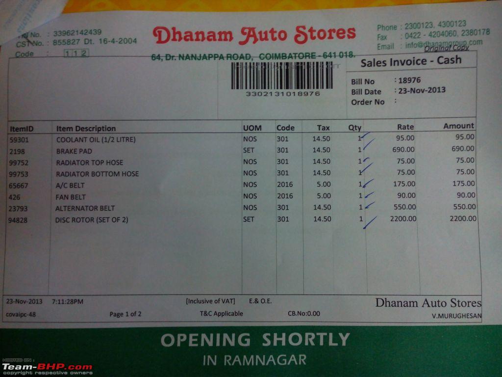

Next set of works were completed for the S10. Never touched the brakes so far and the rotors had to be replaced. So decided to change rotors and pads for the front along with shoes and cylinder for the rear.
P.S: The radiator hoses and fan belt are for my Select whilst the AC belt and alternator belt are for JayD's S10 that's getting ready

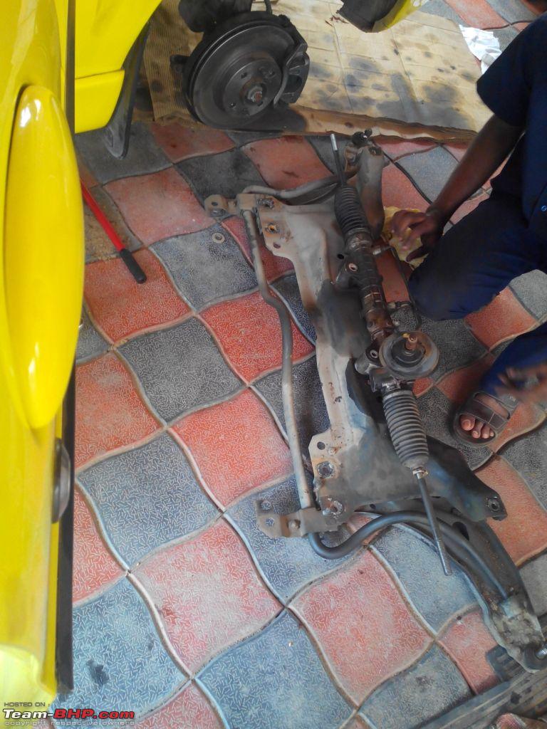

Steering Ball Joint
The inner ball joint was the one who was making noise over rough patches. It was very irritating and used to be occational sounds which started increasing. The steering box had to be removed for this job. Also changed was the tie-rod end.

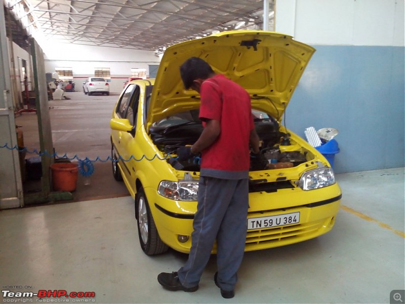

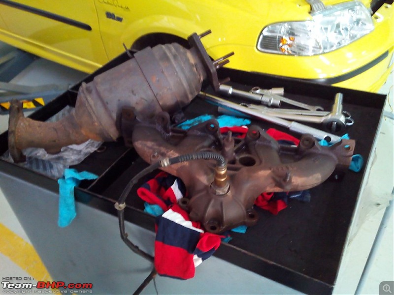

FFE Installation
With brakes and balljoints done, it was time for the exhaust. This needed a ramp and also facilities to weld and naturally cannot be done at home. Was confused on where to get it done in Coimbatore and thought of why not check with FASS!
Called up the service manager of CAI FIAT, Mr. Harish and he was glad to do the job. So sent the car with the exhaust hit to CAI. I was very impressed with them when I had taken the Linea previously for some works and had the trust and confidence, but was not sure if they would do the exhaust work for me. Them accepting the job was a pleasent surprize and were positive signs for Palio owners in days to come.
Since I was not availabe for the next few days, they offered for a pick up of the car from my place. The following day being monday, they picked up the car around noon. I did not pressurize them but told that I need the car by Dec 27 friday since Dec 28 I was supposed to leave to Kodai for the FIAT meet and they agreed.
But due to heavy volume of vehicles, they started work on the car only by tuesday evening.

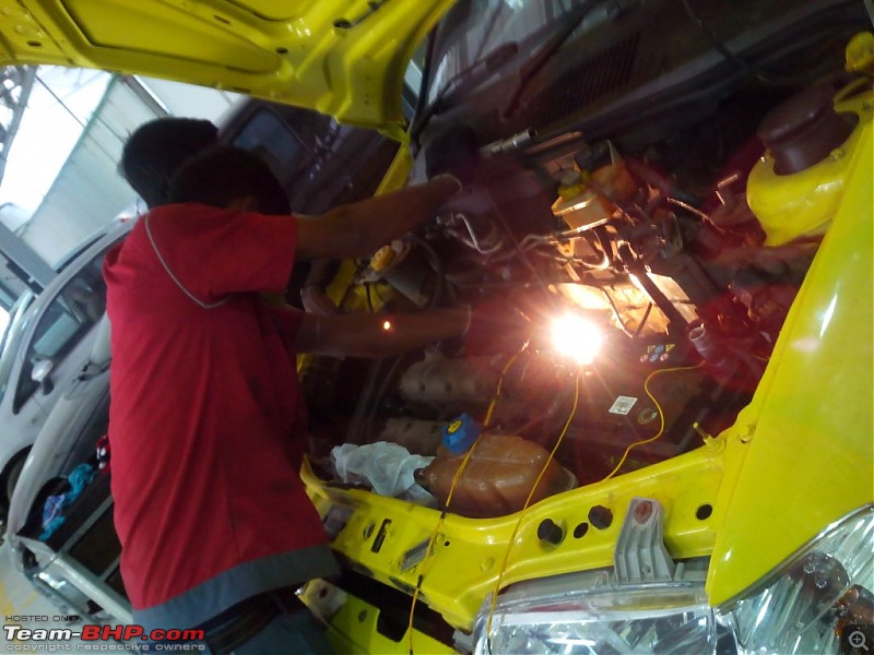

Finally the car was ready on Dec 27 and took delivery around 3 pm. Along with exhaust, coolant leak was arrested, radiator flushed along with general checkup. Took delivery and drove out happily and at the least expected place, the car stalled and refused to start :(
Luckly my driver was available near to the place where the car stalled and he was there in 5 minutes and we pushed the car aside. Also called CAI and they rushed to the spot.
The issue was due to the water wash done in engine bay
Well it was a lesson learnt the hard way. The car then started after cleaning a few fuses and they took the car back to CAI while I had some other work to be done.
Since I was supposed to leave to Kodai the next day, CAI team worked over time to clean and fix the car. Finally the car was deliverd at 8pm with the issues resolved.
Oh yes, the exhaust sounds sweet! Its not an outright loud one but a sweet note which would'nt irritate fellow human beings.
End of the day huge thanks to the entire team of CAI FIAT for their support and care and making the car road worthy in time for the meet.

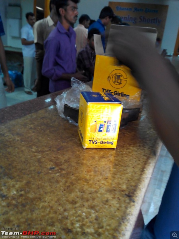

Headed back again to CAI and they inspected and found the leak to be from the sump. They confirmed that the sump does not have oil seal but rather use a paste to seal. They also suspected leak from another area and requested some more time to investigate. There was again a minor coolant leak from the same area they fixed before the Kodai trip.
So left the car in there and headed back home. Evening got a call back stating that the front end oil seal also needs to be changed and the part needs to be ordered. That was the time when the plant was shutdown and waiting for the plant to resume and to order the part will be a long wait and so I offered to get the part from the ourside market and they were co-operative for the same.
So headed to Dhanam auto stores, they had almost all the other seals and packing kit but this one was not available. They took my ordered and promised to arrange in a couple of days and delivered the part in the said time.
So with the above works done and the radiator top hose changed, the car was back home, but I'm in chennai now and haven't driven it. Dad said that the work was neat and no signs of any leak. Have asked him to drive and let me know the feedback.

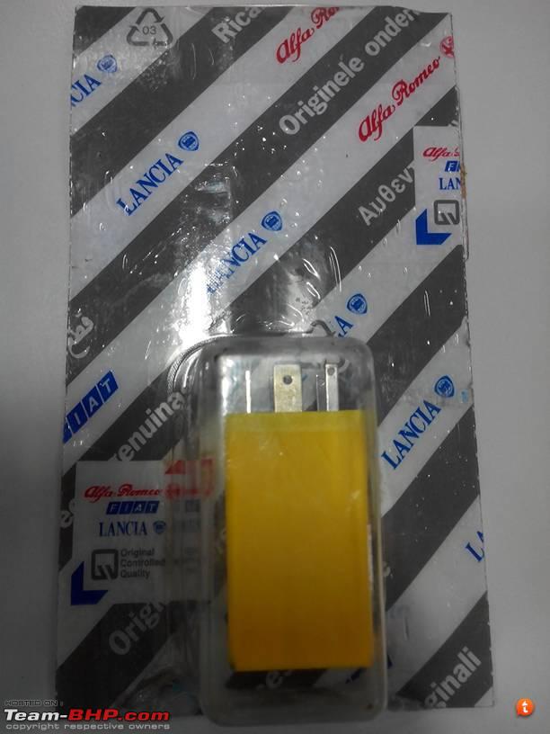

Then got the o2 sensor and central lock relay replaced (I got the parts from Ramkay Fiat Chennai). I visited CAI to check on dad's Linea which is there at present for some body work and so got the sensor and relay replaced in CAI.
The job was done in minutes without any fuss.

Now for the question of why the o2 sensor is changed? Well, people recommend changing the same every 50-60k kms. A faulty o2 sensor leads to sending incorret signals to the ecu which in turn would hamper the fuel delivery to the engine.
In my case I was experiencing inconsistent fuel delivery and we were suspecting the fuel pump to be faulty, that's when my mech suggested to check the o2 first as the o2 would alter fuel delivery if unburnt fuel is detected. Similar to what he said, on changing the o2 I drove extensively for 3 days and the previous issue of fuel supply getting blocked never cropped up.
Pending would be to try and fix the fuel guage issue without replacing the pump, minor rattles from the dash, replacement of wheel bolts (rusting found) and finally on the interiors.

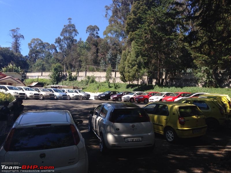

Re: Blessed with a Palio S10! Refurbished it too
The first video posted is mine and car runs on leela tuned spec with FFE. It's a bit loud for daily use and can give you all the wrong attention.
The second video was of our fiat meet in ooty and the car uses raj Hingorani side exhaust. The same is extra loud for daily usage
