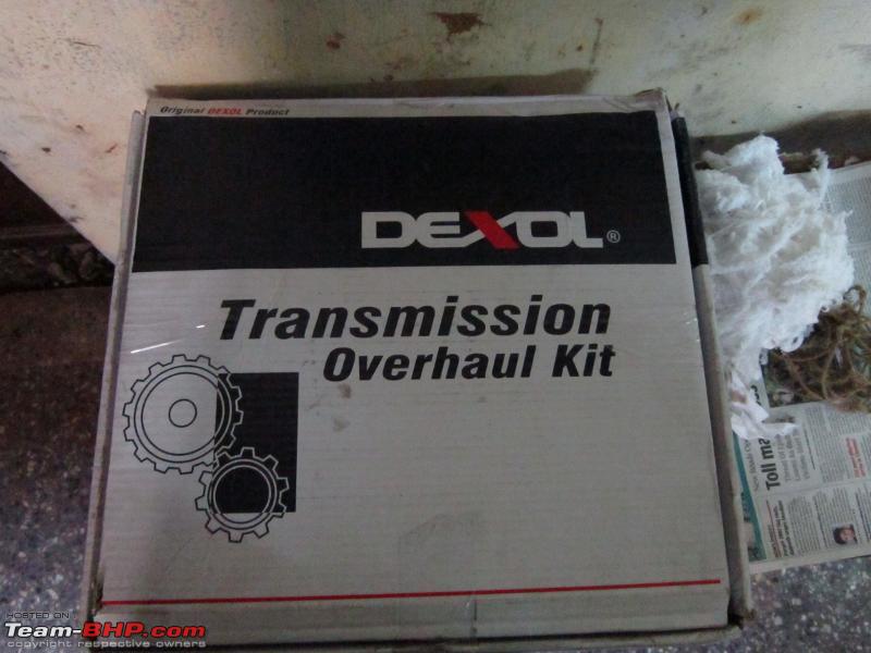

Old 22nd February 2014, 01:44   #18
Posts: 69
Thanked: 29 Times
re: Honda Accord: AT gearbox problem
I did not have the pictures ready when I made the previous post. Below are the pictures of the gearbox rebuild kit, and the gearbox open when it was being worked on.
Honda Accord: AT gearbox problem-00.jpg
Honda Accord: AT gearbox problem-01.jpg
Honda Accord: AT gearbox problem-02.jpg
Honda Accord: AT gearbox problem-03.jpg
Honda Accord: AT gearbox problem-04.jpg
Honda Accord: AT gearbox problem-05.jpg
virtualdanger is offline   (2) Thanks
Old 23rd February 2014, 17:42   #19
d_himan's Avatar
Posts: 864
Thanked: 958 Times
Why is taking 6 months!? The kit is usually ordered from Dubai and takes a week to arrive. These kits are plentiful since the model is pretty popular. Putting back the gearbox takes 4/5 days maximum - these are not complicated CVTs which most mechanics don't touch. Even if they do it twice (even one accumulator not properly put back can result in the gearbox not working), the whole exercise should be over in 15-20 days! At least, that has been my experience in Bombay.
d_himan is offline   (2) Thanks
