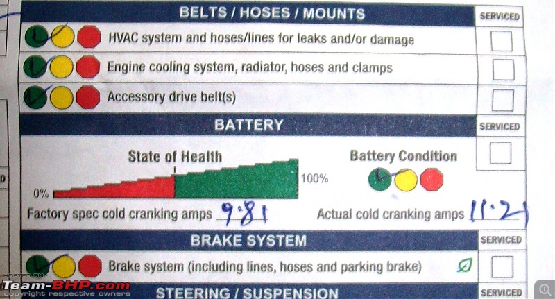

They gave a 'health sheet' from Ford during my last service, in which battery CCA was mentioned.
What am i to infer from this data?
Car Battery: Dos and Don'ts!-104_0023.jpg
