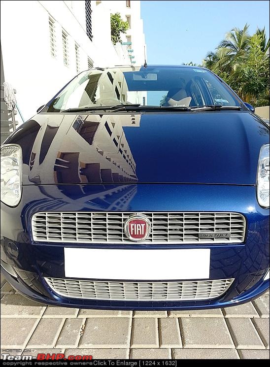

AG Super Resin Polish Review
Product: Super Resin Polish
Manufacturer: Autoglym, UK
Price in India: Rs. 800
I tried SRP for the first time in March 2013. It was my first polishing attempt by hand where I wanted to clean the paint and mask minor swirls and micros scratches all over the car. It is a lot of work trying to polish your car by hand so I took the easy way out by choosing a product capable of masking/hiding most minor defects. I figured that I will use Carpro Reload as the Sealant on top of SRP so it should last at least 2-3 months on the paint.
I do not have any "Before" pictures this time but there were enough paint imperfections that bothered me every time I looked at the car. I polished the entire car by hand using a Gtechniq Tri-Foam applicator and it finished to a stunning shine. Of course, all the fillers were washed off in a little over 2 months but the positive way of looking at filler heavy polishes is that they do not cut/reduce your clear coat unlike compounds and abrasive polishes.
I have not tried it on my rotary yet but after looking at these pictures, I sure will.
Cleaning Ability: Good
Abrasives: Yes (Very minimal just to aid paint cleaning)
Fillers: High (Probably the world's best filler heavy polish to hide minor paint imperfections. Very useful when working by hand)
Gloss: High
Protection: Poor
Stains Trim: Yes
Compatible with most Sealants and Waxes: Yes
Pedaltothefloor is offline   (5) Thanks
