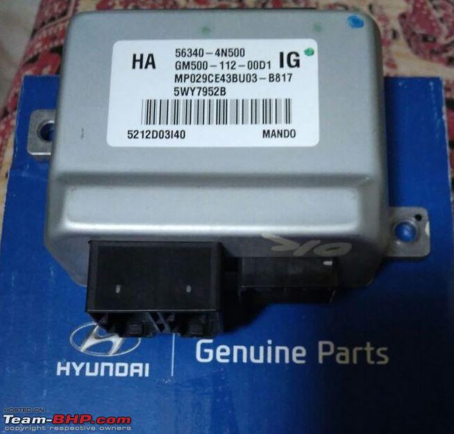

Almost a month over now - with the new EPS controller.
No problems with the steering now (touch wood!)
Here are the pictures of the part replaced (first is the failed one which came in the car and second is box of the new unit) -
- See the crude 'OK' on the part; whenever I see this kind of marking, I feel that it indicates a lack of QC. This is a part which costs Rs. 8,000/- and can't they put a neat sticker to confirm its standards??

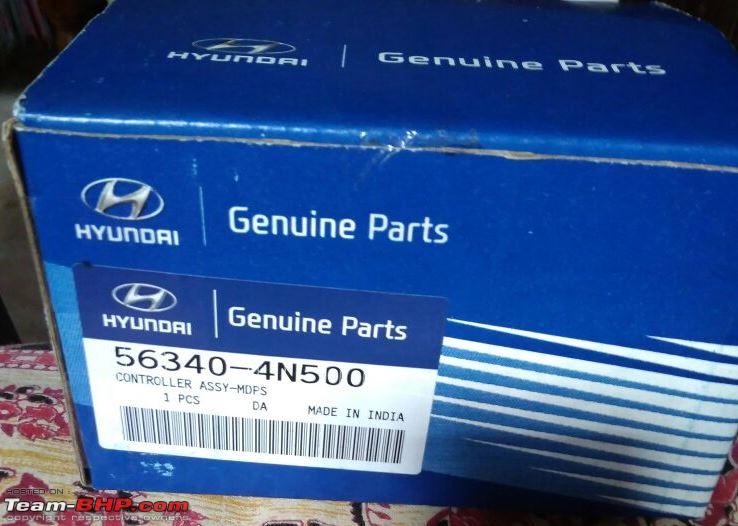

Posts: 16
Thanked: 7 Times
Re: Hyundai: EPS Failure
I was on leave, response delayed.
I am sharing box image for your info
