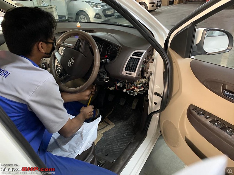

2. The EPS module conked off twice in 2 years and the ordeal I had to go through.
The EPS module when it stops working in Hyundai cars stiffens the steering. As per my experience, when it happened for the first time time in December 2017, the steering used to lose power when taking really tight 2-3 point turns. After the loss of power the EPS light in the dash would come up.
I took the car to Sumanda of Alok Automobiles, an FNG quite famous amongst Bhpians in Kolkata. I have been getting my car serviced there since 2016. He checked and replaced the module for INR 5500 (approx.)
Cut to 2019, the problem reappears again. I take the car to him and for some reason he fails to recognize the issue. Since it was early days of the problem, it did not reappear quite often and that could be the reason he did not acknowledge that the problem was back.
Just before leaving for Delhi I decided to take the car to him one more time as I did not want to take any chances since it was a 1500Km trip. This time he acknowledged, however, the part was not available and I could not get it fixed. Nevertheless, I drove the car to Delhi without any issues. In the meantime (during the drive) JKDS suggested that I source the part from an authorized Hyundai Part re-seller and get it fixed by Imtiaz (another famous FNG guy amongst bhpians, but in Delhi).
So one Saturday, the 3 of us went to Kashmiri Gate and picked up the part. What surprised me was the price. It costed me INR 8350 (as compared to INR 5500, the previous time I got it done).
INR 8350 was the cheapest. First of all, the part is very difficult to find, even at a place like Kashmiri Gate. And, INR 8350 was the cheapest I could get. Bought it from BKS motors.
Imtiaz was not available so I got the part fixed by Babu. Imtiaz, Babu, Ayub are all excellent mechanics who work on cars in GK II. Babu, a gentleman himself, was so shy that he did not even ask for any money after fitting the part. (I paid him anyway). I guess it was because of the good relations JKDS and Altocumulus had built with them over the years.
However, here starts the ordeal. The part was new and hopefully it was original. BUT the problem did not go away. The steering would still shudder and jerk and would sometimes be light and sometimes be very hard. I got really sad. After all the effort of getting the part and all the pain, the entire mission was unsuccessful.
Day before yesterday, while I was still using the car with the EPS not fully working (it was manageable but was bothering me a lot), I took the car to Nimbus Hyundai, here in Noida. The guys fixed the car in less than 120 seconds. It was a coding issue. They pointed out that since the part was fixed by an FNG they would not have access to the software and codes. The steering is perfectly normal now and works fine.
So guys, everyone who is suffering from the EPS failure, here are a few tips:
1. Try and get it done from the authorised service center. They charge around 10.5 to 11K. I got mine from Kashmiri Gate for INR 8350+ INR 200 (fitting charge) + INR 826 (coding)= INR 93XX. I think the difference is not worth all the effort of sourcing the part yourself.
2. If you decide to get it done from outside do get it coded.
3. MOST IMPORTANT: There are 2 types of jobs offered when it comes to EPS failure: 1. Replace/new part, 2. Repairing the old part (half the price). I am not sure how I was charged only INR 5500 last time. I somehow feel I was given a repaired module last time considering the price charged to me and that it lasted only 1.5 year.
So please try and get a new one and dont get it repaired.
These were my 2~3 cents on the EPS failure.

Since the car was not in a drivable condition as the steering wheel was rock solid (almost) I had requested for a pick up and drop from them. Also, I knew I had to drop off the car at the workshop so getting back in public transport during these COVID times was not something on my agenda. So I followed the pick up guy - Indrajeet in my Santro. He drove the i20 quite well with that steering wheel.
Car at the service floor.
2011 Hyundai i20 Asta. EDIT: 62000 km up & EPS module changed twice-1.jpeg
2011 Hyundai i20 Asta. EDIT: 62000 km up & EPS module changed twice-2.jpeg
The car reached the A.S.C sharp at 10am and I was promptly attended by Tarak. There he was - a Youtuber technician. Wow. Jokes apart, he, along with another Service Advisor, Mr. Gupi quickly ran a thorough diagnostic. The visit would also entail a routine service - oil/filter change, etc.
Tarak, along with Abhijeet (he is another Youtuber btw with an even larger following) quickly checked the car. The issue was the EPS motor. How much - INR 4500 + Labour. Would you believe it? 30K to 5k. This is cheaper even after spending on transporting the car from Delhi (20k). This was a dream run. I knew I was in good hands, I got the correct quote, diagnosis was top notch and to top it all he said he would get the car ready by next morning. I was head over heels. Literally. However, the part was not available. Not to worry - Tarak said he will arrange it by evening from another one of their workshops. Did he? Yes.
We chit-chatted for 10 minutes. He explained how they work here and that he looks after/supervises the technical side in MH. Fully satisfied, I returned home in my Santro.
At 8pm, I got a call from him confirming the arrival of the part and that he has already fixed it. Steering works fine now. The car will be ready by tomorrow first half.
I was relieved. Next day I reach in the evening as I had back to back meetings till 5pm. Tarak had assured me that he would stay back late for me so that I could come after work. I was not super late and he was there with Mr. Gupi.
The car steering issue was gone. The wheel felt like the issue never existed. The car was cleaned and the interiors were polished. I also had the headlight replaced as it had cracked. Gupi explained to me the bill details. Tarak came with me to the car and asked me to keep it in use for as long as possible and let him know if there are any more issues.
Overall, the experience, their behaviour and their conduct, only instilled confidence. To be honest, I have had average to poor experience with every other Hyundai A.S.S in my city and in NCR. And then this happened. Compared to the INR 30k quote received from the NCR HASS for only the steering work, I got the entire 70k service done along with the steering problem fixed at INR 16.5K.
