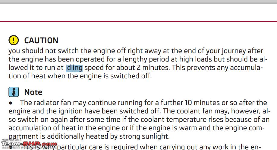

I doubt that very much. The idling rule for turbo's for cars stems from a long time ago. These days very few require it. Check you owners manual, and if it doesnt mention it, you dont need to idle it.
There's no room for doubt. The VAG's 1.8 TSI is as cutting-edge a petrol engine as they come in the mass market. Here's an extract from the owner's manual of the engine being discussed here:
http://www.team-bhp.com/tech-stuff/idling-rule-turbo-charged-cars[/url]
You will see some who favour the rule and some, like me, who dont think it is relevant at all. When in doubt, consult the car manual, not the internet!
Take a look at that thread and you'll see a lot more owner's manuals recommending the same thing.
End of the day, what have you got to lose? To me, it is logical to idle the engine.....especially since so many manufacturers recommend it too. For the ones that don't, neither do they categorically tell you "NOT TO" idle the engine after a drive.
In summary, 50% of the owner's manuals I've seen tell me to idle the engine. But not a single one tells me NOT TO.
GTO is offline   (14) Thanks
Glad to see you are in full agreement with my earlier statement "always go by the manual and not by the internet!" I'm also glad to see that you actually do read manuals when the need arises I assume, contrary to your earlier statement:
http://www.team-bhp.com/forum/techni...ml#post3649635
I agree there is nothing to lose, as I said in that very same idling rule thread. If it makes you happy, comfortable, by all means idle away.
Statistically speaking though, the vast majority of turbo engine car owner actually aren't even remotely aware there is such a thing as an idling rule. And as discussed in the "reasons for reading your car manual thread" I get the impression few people do read the manual to start with.
Still, not to many problems out there in the market with turbo's due to lack of idling.
But again, I maintain my oftern voiced stand, read the manual, don't take to much notice of the internet and make sure you enjoy your car!
