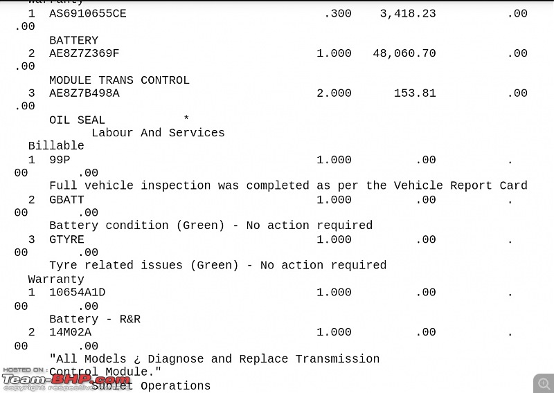

Here is the bill we were given after the delivery of the vehicle:
Ford EcoSport 1.5L AT: Transmission Control Module replaced under warranty at 26,162 km-identity-blurred-bill.jpg

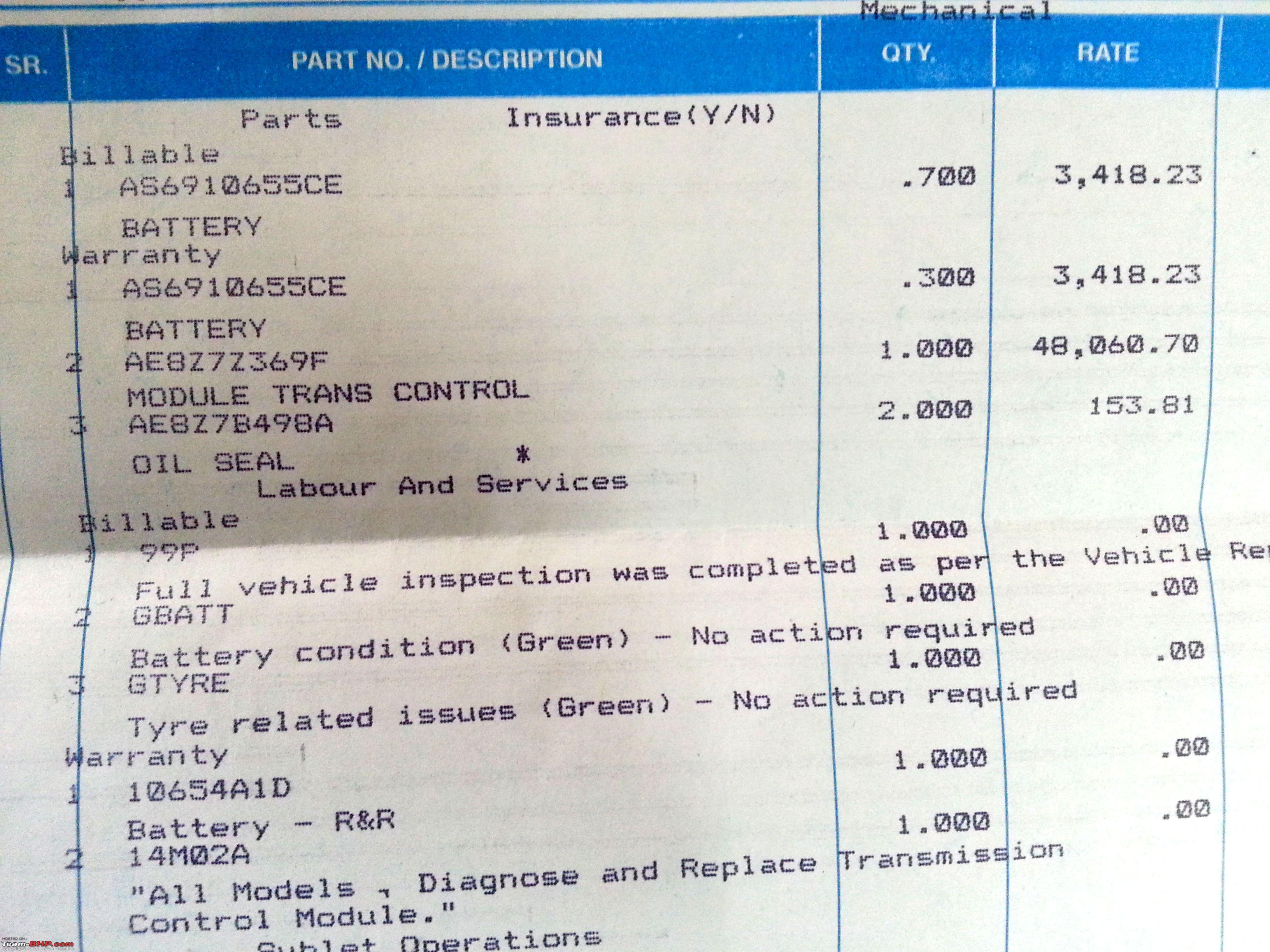

Close up of the bill showing the details:
Ford EcoSport 1.5L AT: Transmission Control Module replaced under warranty at 26,162 km-tcm-original-bill-close-up.jpg
e-copy of bill part 1:
Ford EcoSport 1.5L AT: Transmission Control Module replaced under warranty at 26,162 km-identitiy-details-deleted.jpg
e-copy of bill part 2:
Ford EcoSport 1.5L AT: Transmission Control Module replaced under warranty at 26,162 km-tcm-replacement.jpg
