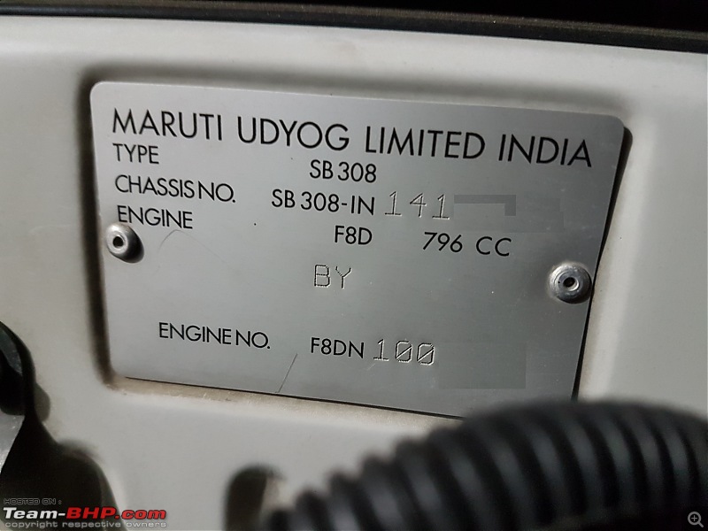

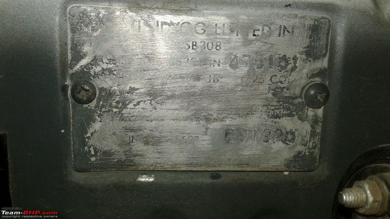

Dear Team,
A close friend's 1991 Maruti 800 is getting restored. It's VIN plate is badly damaged. What options do we have ??
Pic of the damaged VIN Plate
Chassis number / VIN has gotten completely rusted-img20180221wa0000.jpg
Pic of an unscathed VIN Plate
Chassis number / VIN has gotten completely rusted-20180220_174942.jpg
Can we make stencils and then paint it?? As it's evident in the 2nd picture, some part is embossed while some part is painted.
Shashi

Hi shashi,
the plate has screws and thats great to get the plate removed, rivets are a pain and what i would suggest is clean the plate or get a similar sized one, get a sticker shop to print the information you need and stick it on this plate, the numbers that need to be punched can be punched in a lathe,once all done you can mount the plate back.
