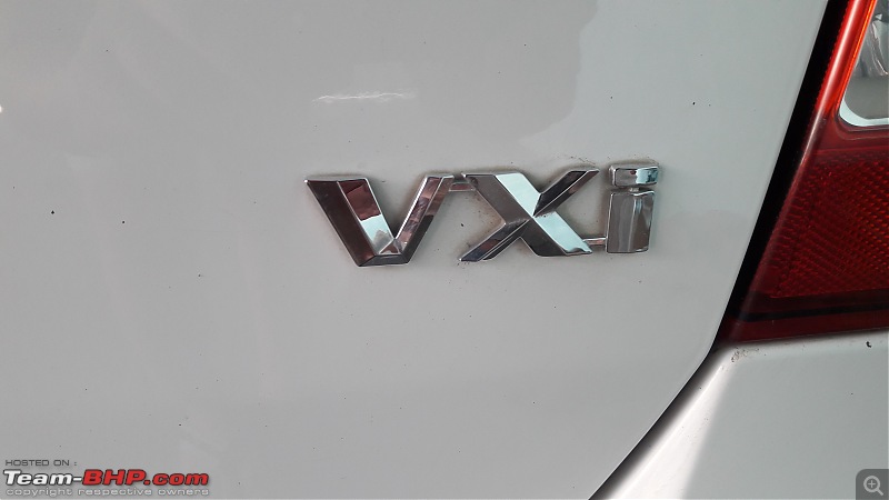

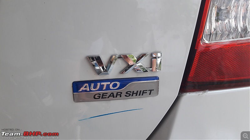

The badge compared to our existing wagonR
Rust formation on brand-new WagonR's roof? EDIT: Not rust, resolved!-20170906_160045.jpg
Rust formation on brand-new WagonR's roof? EDIT: Not rust, resolved!-20170906_160131.jpg

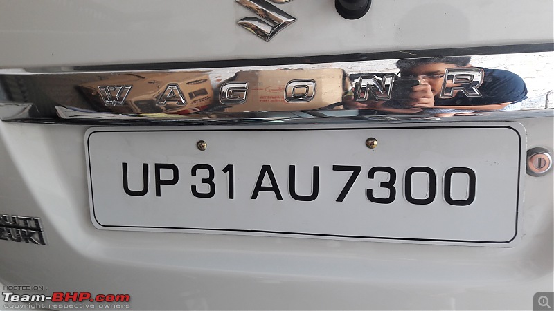

Number plates compared:
Rust formation on brand-new WagonR's roof? EDIT: Not rust, resolved!-20170906_160038.jpg
Rust formation on brand-new WagonR's roof? EDIT: Not rust, resolved!-20170906_160123.jpg
