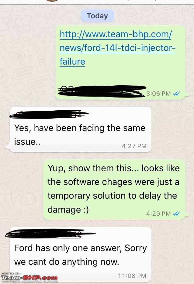

Ford 1.4L TDCI: Injector Failures-2e56be11afcb430ca841eabc85eafe08.jpeg
A friend of mine from Delhi has been facing this issue, his car has run 112k kms or more and has been following it up for quite some time with Ford service center. I forwarded this link to him and he was convinced its the exact same problem with his car too.
Attaching his reply !
Too bad, it almost looks like Ford knew about it all and waited for the cars to go out of warranty. I could go to the length to call them a bunch of scamsters !
