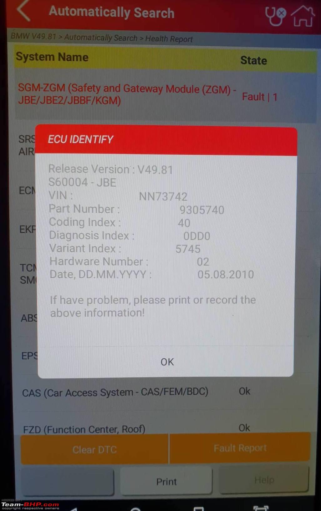

Scanned it today using the launch scanner and came across these
BMW 3-Series (E90) - Completely switches off on the move!-33189366_1851310861588287_5164314675810140160_n.jpg
BMW 3-Series (E90) - Completely switches off on the move!-33358624_1851310158255024_7417213279568658432_n.jpg
Also had a check engine light for a few seconds but disappeared and didn't appear again. Just cleared the fault codes and gonna try it for a couple of days... Lets see...
I'd recommend starting with the basics i.e the power source to the entire vehicle which in this case mean the battery and alternator and their electrical connectors, cable, fuses and any relays for e.g. that DTE relay. If these check out OK you could proceed to checking other components as shown by the scanner.
Incorrect voltages and/or faulty earthing can cause electrical and electronic components to malfunction which in turn could throw up error codes. If you were to visit the ASC they would obviously blame components and suggest replacements when the fault could really be elsewhere.

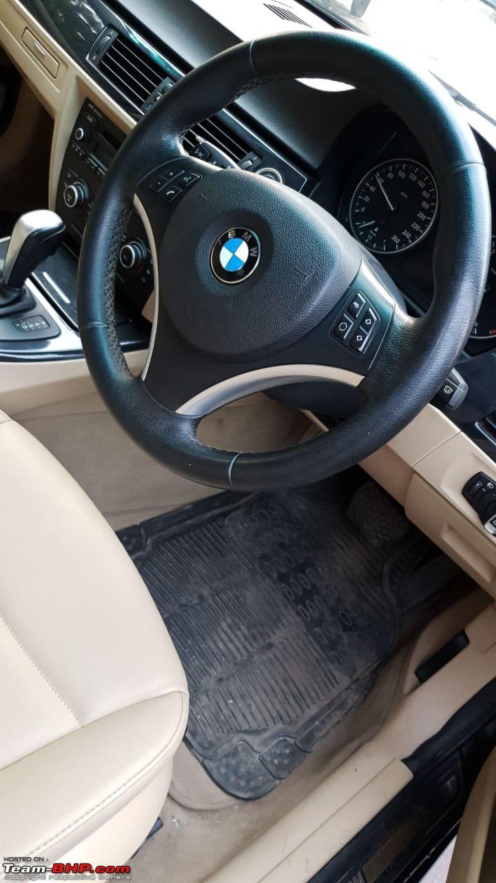

In one of the pics of the dashboard, I see your speedo stuck at around 60 kmph.
That is serious. AFAIK, the electric speedos should fall to zero in case of loss of power ( mechanical ones will ofcourse fall as soon as car comes to a stop)
What am I missing here? IMHO, the issue is something more complex than a loose connection with the battery.

Seeing those many errors makes me feel that either there was a power supply issue(causing a voltage drop across the system and logging the errors) or that the car has some electrical modifications in the aftermarket. Some of the errors are due to the sudden power loss. But there are others like headlights and door switches which do point to some electrical issues. If it is indeed a short circuit as indicated, it would result in some fuses blowing out.
Modern Speedometers and other cluster meters are driven by stepper motors in most cases. Stepper motors need power to return to its zero position and cant return to zero if there is a sudden power cut, neither can they be manually rotated back to zero by hand. Hence in many accidents the speedo needle gets stuck once the power from the battery is cut off.
