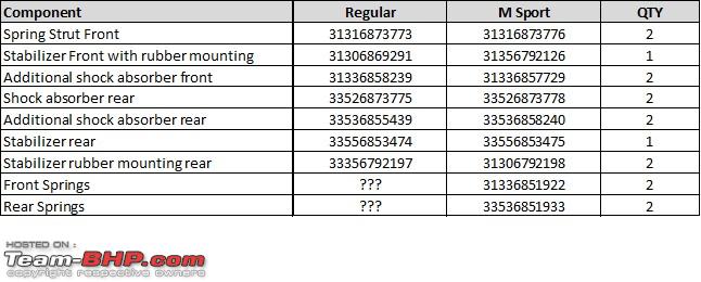

I searched through the front axle and rear axle subsystems and extracted the part numbers for the front and rear struts, front and rear stabilizers and the mounting bushes.
Then came the first road block. When I tried to get the part number of the springs, this is what I got.
Installed: M-Sport Suspension in my BMW 330i GT-etkbmw-front-spring.jpg
The part number for the spring was not available. I visited the BMW workshop and Mr. Yadhav then opened their own internal part catalogue, and to his surprise, even in their system, the part number for the springs was not there. This was followed by about 20 days of wait where Mr. Yadhav exchanged mails with the Delhi office and they in turn sent the enquiry to BMW head office. After about 20 days, he got the part number confirmed for the springs. Here is the full parts list.
Installed: M-Sport Suspension in my BMW 330i GT-part-list-complete.jpg
Then they raised the quotation for the spare parts and installation. The cost of the spares was about 2L and installation was about 50K. I had checked the cost of the spare parts in another online stores Schmiedmann and considering import duties and shipping, it worked out to be the same. However, I felt the installation charges were on the higher side. I then spoke to Akshay1234 and a contact in Navnit BMW in Bangalore (thanks to the Bangalore TBHP friends RSUDARSANAN, Robi and Diesel_Convert), and they confirmed that there will be some variation in installation cost between various dealers, but 50K was reasonable, as the suspension upgrade involved changing the front and rear stabiliziers as well which required considerable effort. So, I went ahead and placed the order and paid an advance for the parts.
Note: In the initial stage of part selection, I visited KR Motors in Coimbatore who specialize in servicing German cars. I had the coilovers and the Tarox brake discs for my Polo GT installed here and they did a fantastic job. Mr. Kanagaraj of KR Auto then got the part numbers for the springs from one of his sources. But as I wanted the warranty of the car to be intact, I decided to get the job done at the BMW workshop. And it happened that the part number for the springs that Mr. Kanagaraj got was the same as the one we got confirmation from BMW.

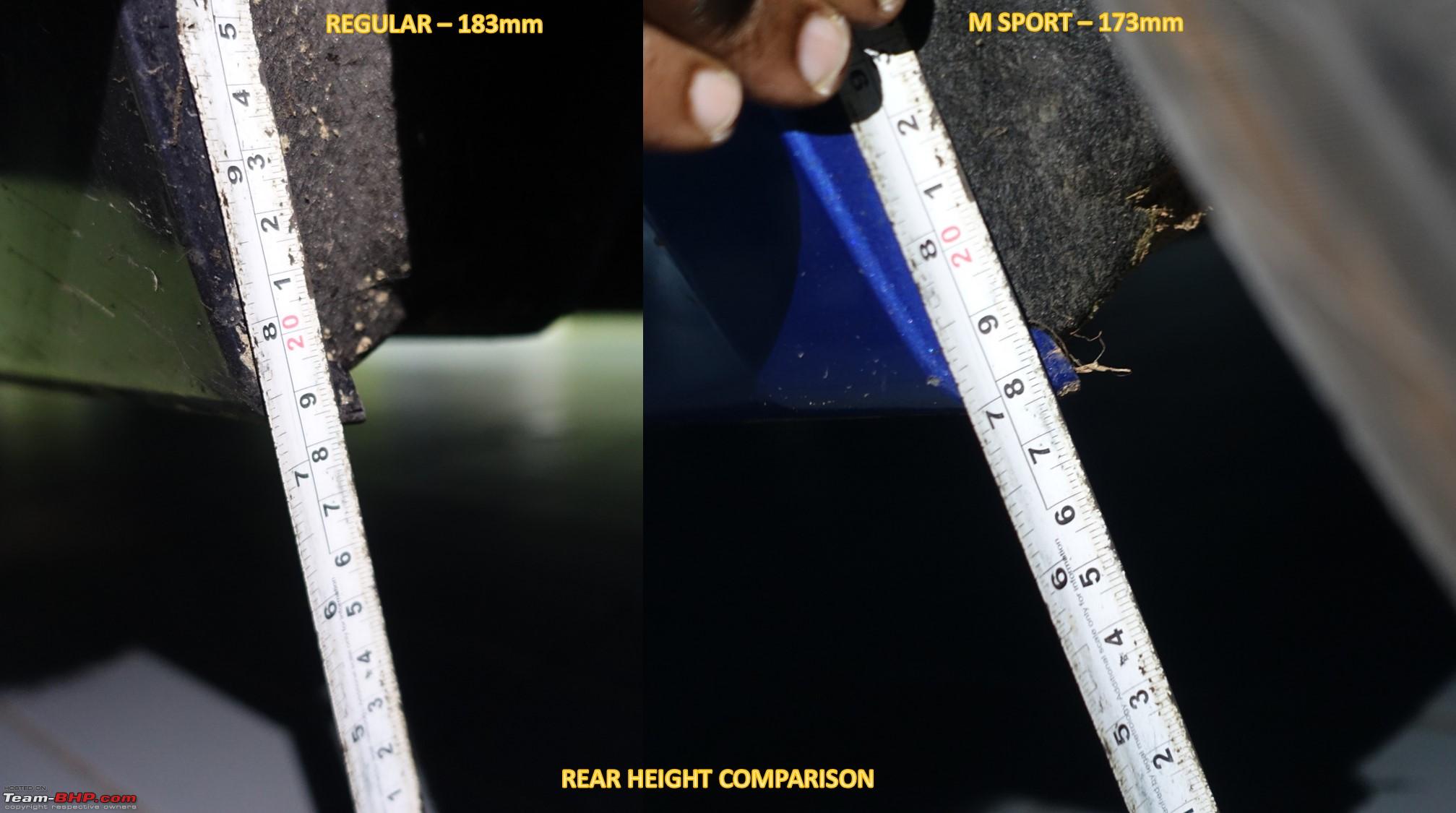

One of the concerns I had while getting the M Sport suspension upgrade was drop in ride height. Though the high GC of the GT is one reason for the body roll, it also gives lots of confidence in taking bad roads with potholes and craters. From the information I got from various forums, I was expecting a 10mm drop in height with the M Sport suspensions. The GT has a very high ground clearance and 10mm should not be a problem. Anything more would be a concern.
To get a clear idea of how much the car is lowered with the M-Sport, we made some measurements with a 320d GT (test drive car), and my 330i GT.
These measurements do not indicate the actual Ground Clearance which I really do not know how they calculate. These measurements were done on specific points in the front and rear bumper to get a relative comparison.
Approximately 10mm drop in the rear.

Next, we measured the suspension sag with 4 passengers on board. This also was done with the same reference points. We measured the height with the car unladen, and then with 4 passengers. Results below.
Suspension sag in regular suspensions - approximately 25mm
Suspension sag in M Sport - approximately 10mm. This lower sag compensates for the 10mm drop in ride height
The test drive GT and my 330i GT with M Sport side by side (no load). The drop in ride height is visible only if we are looking for it. Otherwise, both look the same.
