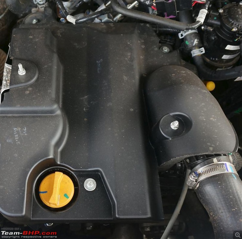

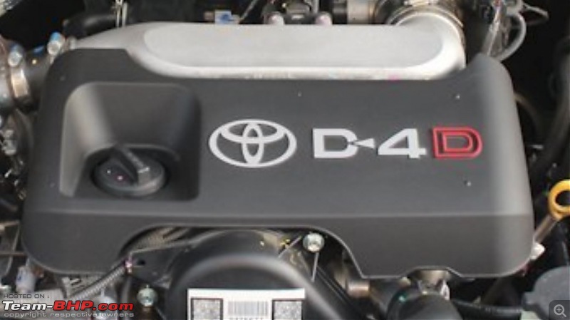

This is a TUV Engine cover - I would have probably designed a better way to fix this for my Engineering project and here you are trying to defend this company. I have also pasted an engine cover from Toyota.

Now contrary to people swearing of not buying any Mahindra product again or recommending on the referred thread, I don't think many people (Toyota customers) are going to fret over this issue (again my perception and I can be wrong). As for me, I am not going to stop buying Toyotas any time sooner
However that does not mean that Toyota is a saint either, they should have done a better job in changing the parts especially if they have done elsewhere.
