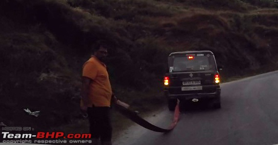

At times, all things may not go in favor. Today while doing postmortem of events, many things could have been done differently. On the ground, realities, pressure, experience are very different.
It was a 5 ton tow rope/strap which was used. Not a steel cable.

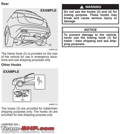

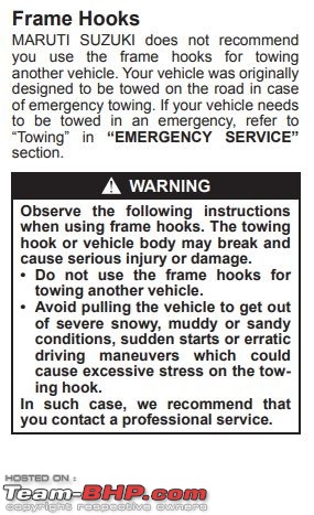

Posting some extracts from S Cross owner's manual

Well, you may use it at emergency situation, but not a Hatchback to tow a SUV (for an example) Even the rear tow hook is designed for shipment purpose only, the one on a heavier vehicle should be designed to tackle the vehicle mass during transportation. So the factor of safety to tow a smaller vehicle will be higher.
