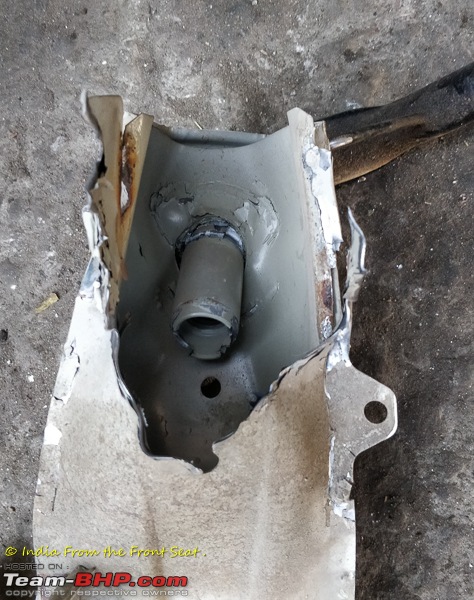

Laluks, is the towing hook attached only to that thin metal piece placed infront of front member ? I believe in Old S-Cross and other Maruti cars, towing hook will go inside the hole in front member and attached to member, side apron.

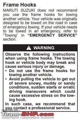

My Ritz manual clearly states that this tow hook is NOT meant for towing or being towed.
If the Tow hook is NOT meant for towing or being towed, pray what is the purpose of a Tow Hook? Request you to kindly post the exact screenshot from your Ritz manual since I think you're mistaken.

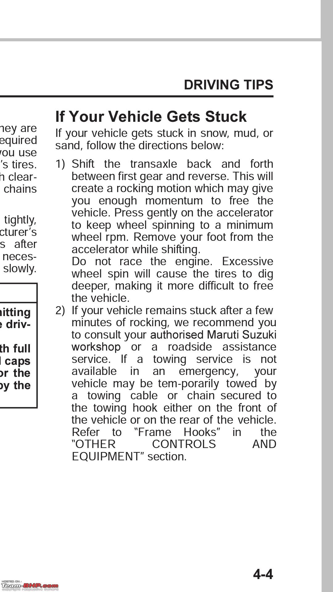

Attachment 1813052
The S Cross Manual which you've quoted says "Do not use the frame hook for towing another vehicle."
It doesn't say it shouldn't be used to be towed.
There's a fundamental difference between the two statements, if you would be observant enough to notice.
Excerpts from S-Cross & Ritz Manual
S-Cross Manual (Point 2 is what was done by laluks sir)
It is only on the sheet metal. It does not screw in all the way to the side apron, it's all in the front member's thin sheet :Shockked:
See this picture.
S-Cross' suspicious build: Towing rips out the tow hook & front members-img_20181015_090656_01.jpg

Sorry to see this laluks!
I think the photos on this page shared by Naren and you make it very clear. MSIL lifted the front end of the S-Cross during the facelift (quite literally) to make the car 'look' more rugged.
But it looks like they didn't think through it properly when it came to the tow hook screw. The travel and grip was limited to the front member alone and that compromised the whole thing. The screw travel needs to extend to the longitudinal beam of the sub-frame as well. Only then can it take the weight of the car properly.
This new design is akin to lifting a bottle of water by gripping the cork instead of holding its neck. The friction between the cork and the bottle neck (or the weld on the sub-frame here) isn't strong enough to take the weight of the bottle and the cork will surely come off if one were to swing the bottle a bit by holding the black screw alone.
S-Cross' suspicious build: Towing rips out the tow hook & front members-facelifted.jpg
But if the screw were to grip the longitudinal member of the sub-frame, it would have been able to take the weight of the car better. And with a factor of safety to accommodate extra load from jolts, shear stress, inconsistent braking etc.
