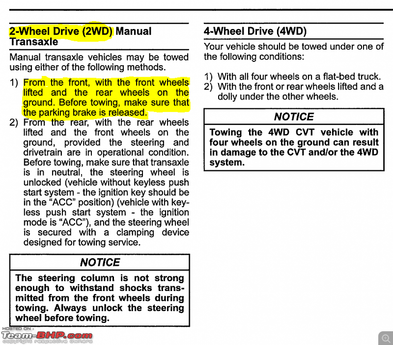

Originally Posted by Leoshashi (Post 4486861)
Do you have a similar screenshot of the Facelift S Cross' manual??
Couldn't find it. If you can find it (which I'm sure you can), please post it. Thank you sir.
Originally Posted by laluks (Post 4486881)
Both manuals are same.
Thank you sir for confirming. Any update from Maruti on the issues? What's the current status of the car?

Here's an interesting info from the Scross Europe user manual regarding the towing method.
So, its either Maruti hasn't tested it properly or they have just copied the words from user manual of other Maruti models.
This is an interesting observation, one that was also called out a bit earlier in the thread.
That said, even if the front wheels are placed on a dolly, the net towing force would be unchanged, wouldn't it? With the tow rope being attached to the tow hook. The dolly wouldn't change the load/friction involved. At most, the angle of the towing force would change a bit with the nose of the car raised, but that should be well within any designed margin of safety/error.

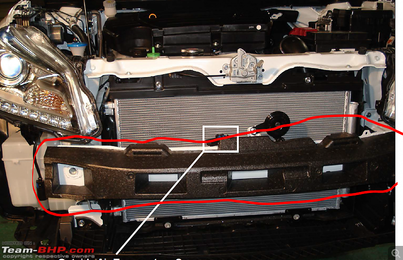

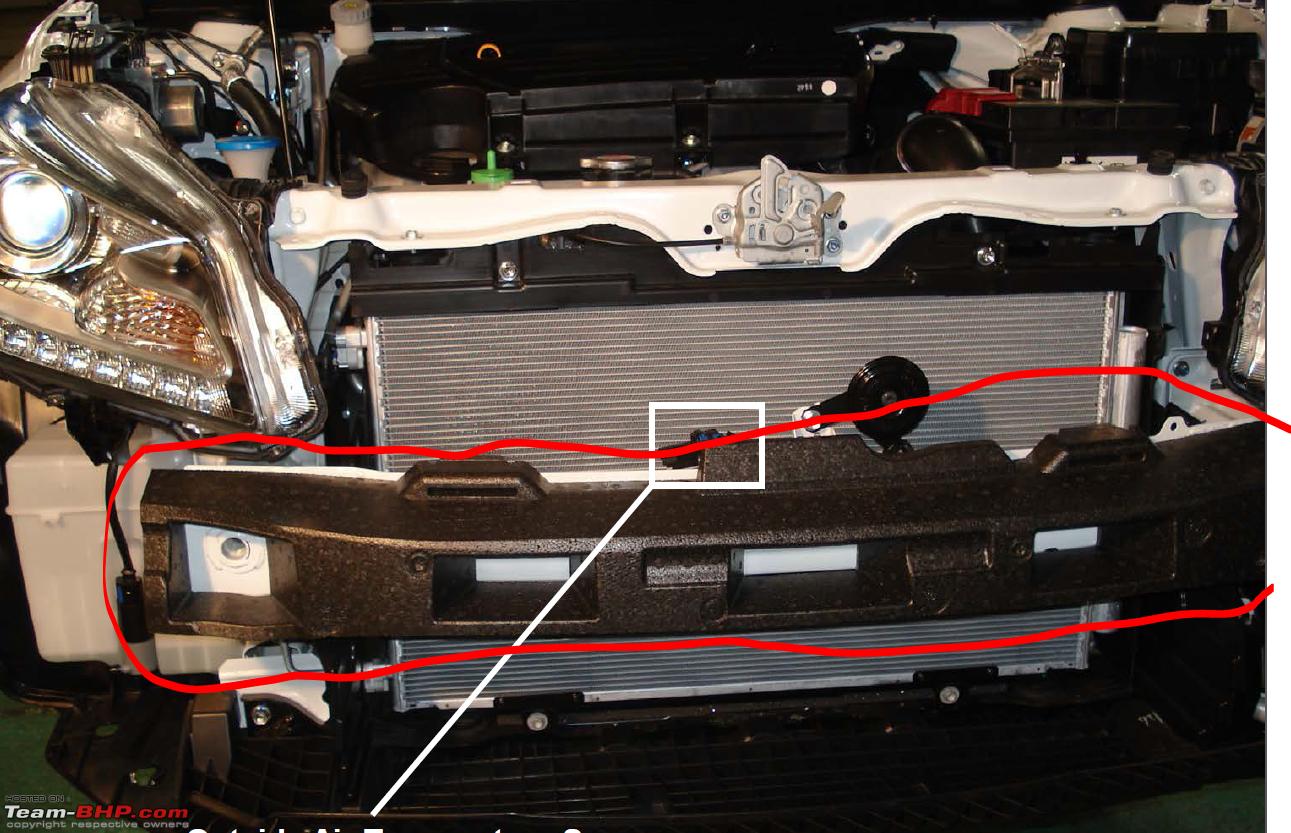

Another observation :
European Scross (pre-facelift) comes with an additional cushion on the front support. (Roughly marked in red)
Don't think it will have any significant impact while towing but shows some value engineering was done for the Indian version and should be applicable to Facelift version as well.
S-Cross' suspicious build: Towing rips out the tow hook & front members-scross-front.png
I guess "value engineering" is the jargon. Cheap engineering is the reality.
Also maybe bad engineering. Shouldn't it be designed to fail without causing so much damage?
Attachment 1814255
Similar cushion type material was noticed on Kizashi too, which was an Import.
https://www.team-bhp.com/forum/techn...ml#post4483982
So definitely, MSIL's bean counters are working overtime here. :deadhorse
European Scross (pre-facelift) comes with an additional cushion on the front support...
That cushion is a critical bit of the actual 'bumper' and intended to absorb some of the impact force in a frontal collision. The outer plastic thingy we usually call the bumper is actually just the bumper cover in reality. There was a picture somewhere on this thread or another that explains it at component level.
What most cars get here is a joke of a metal frame, a couple inches of air - if 'value engineering' even permits that air pocket -
and a few millimetres of outer plastic cover. We're all driving around with almost nothing between our car's radiators and open air.
A sobering thought if one has the misfortune of being at the receiving end of an impact from such a contraption.
