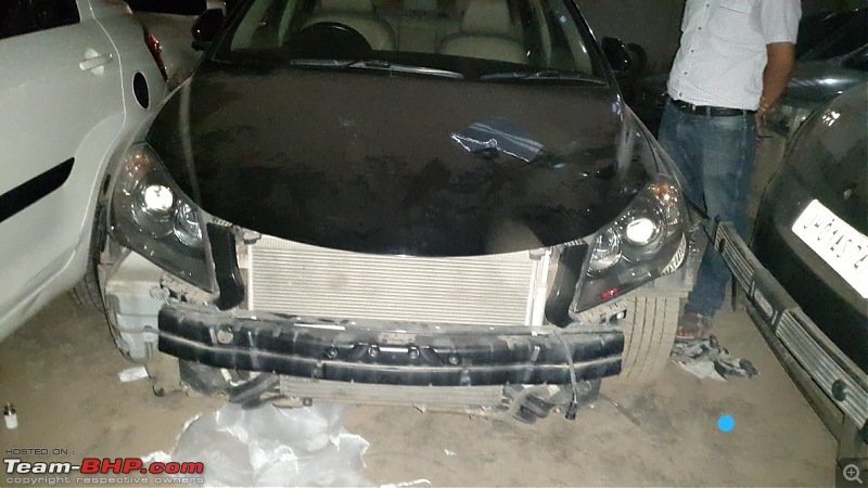

Really sorry to read about and see your experience. Many of us here have held S-Cross in high regard amongst all other offerings from MSIL.
Going purely by the video, it is not immediately apparent what was the need for the Scorpio Driver to start the towing with such a massive jerk to the tow rope?
From the looks of it:
- it was neither a significant incline,
- nor a bad road surface
- the Scorpio, particularly the 2.6 CrDe variant has great low end torque, and S-Cross isn’t exactly very heavy.
That, to me, is simply bad technique that exacerbated & exposed a relatively weak construction, unless there was an obstacle that needed to be overcome.
Can you shed some light on this please?
Sorry to say, but I strongly feel that the jerk was a brutal one. It should have been a gentle tug. It is the pickup and braking which makes towing a tricky business. As rightly pointed out by BHPian Audioholic, do check the apron and front crossmember's measurements.
To me the tug came on the first engagement after start. Then it was always gently pulling along, after we changed to the tow hook at the bottom.
Last edited by manson : 25th October 2018 at 15:35. Reason: Deleted excess rows between each quote and reply.

Lalu, a few questions:
1) You drove all the way back to Bangalore? No overheating problems?
2) Are these broken/sheared members part of the chassis? Or are they bolted on?
3) Do you think structural integrity of chassis has been compromised? In case of accident, will crumple zones work as it is supposed to? Find out where the airbag sensors are and see if it has been damaged.

1. We attended to the radiator leak locally before starting back. So all is well on that front. The engine temperature was in its optimal state. I need to replace radiator.
2. Broken one were all bolt on components.
3. Don't think so. But need to check the bend on member B. The airbag sensor near B was ok, will check that anyways. Thanks for the hint
