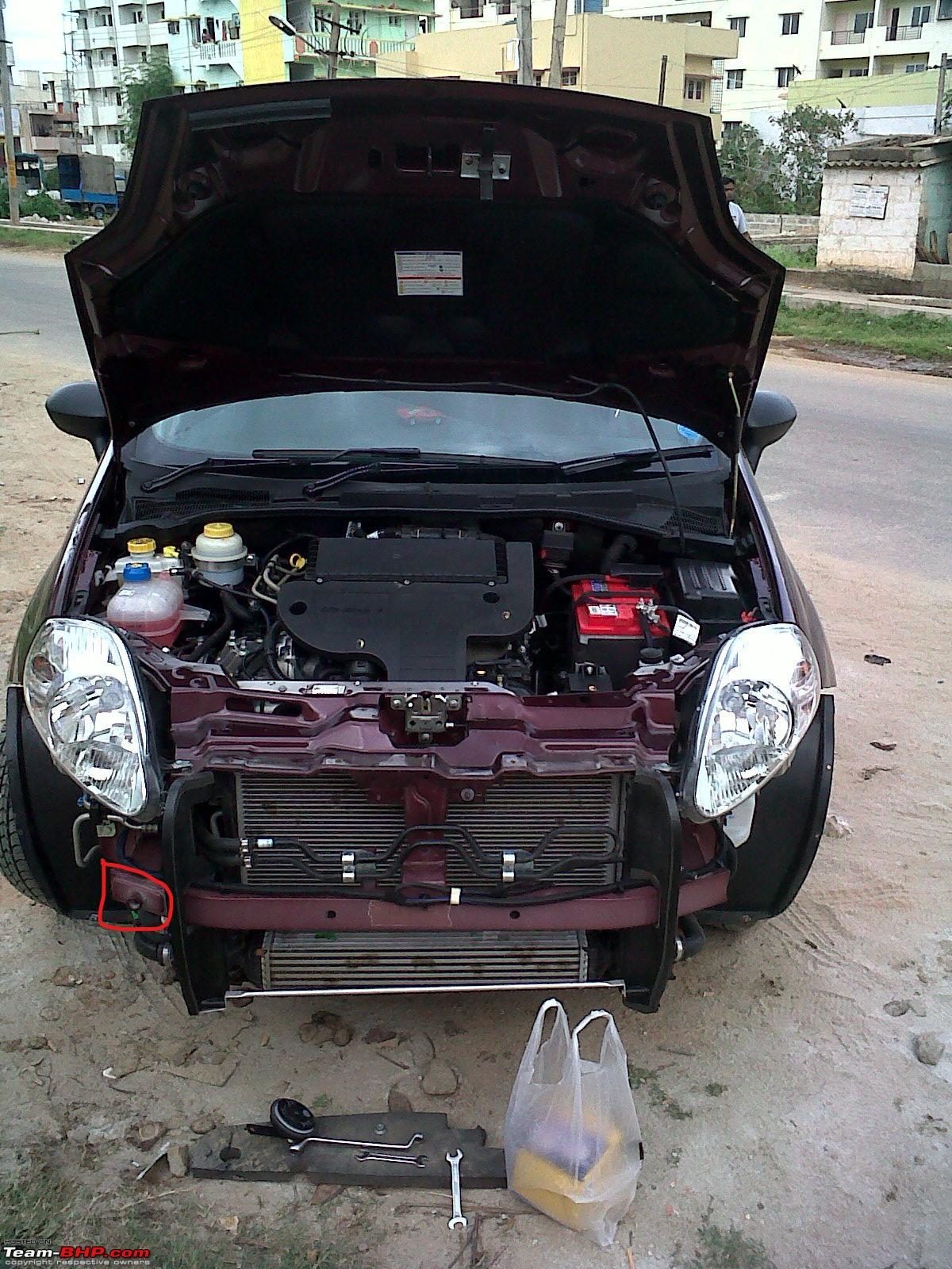

For me, it points to a design failure - these are parts which should withstand abuse and the manufacture have not factored in the amount of force applied to this particular part, which resulted in easy failure. I hope the manufacturer reach out to you and offers an explanation at least.
Leaving the picture of how the part looks on a Punto:
S-Cross' suspicious build: Towing rips out the tow hook & front members-inkedimg00101201106251546_li.jpg
--Anoop
