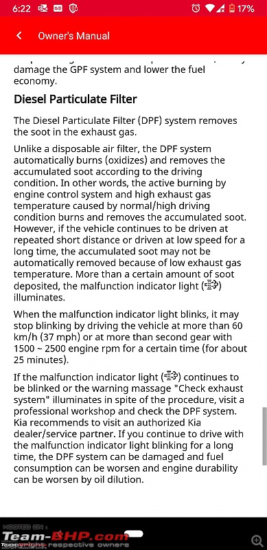

Yes, these cars don't have a separate regen mode. The regen happens in the background once it is due. If your driving conditions are not suitable for regen, then the process will be postponed. After a point when it can't be postponed anymore, a warning light lits up on the dashboard after which you are expected to perform the regen process diligently. You are expected to drive at higher gear, higher RPM for 30 minutes for regen to happen. Once successful, the light goes off. If it still fails, you visit the service center for manual cleaning.:D
See the instruction from the Seltos user manual
