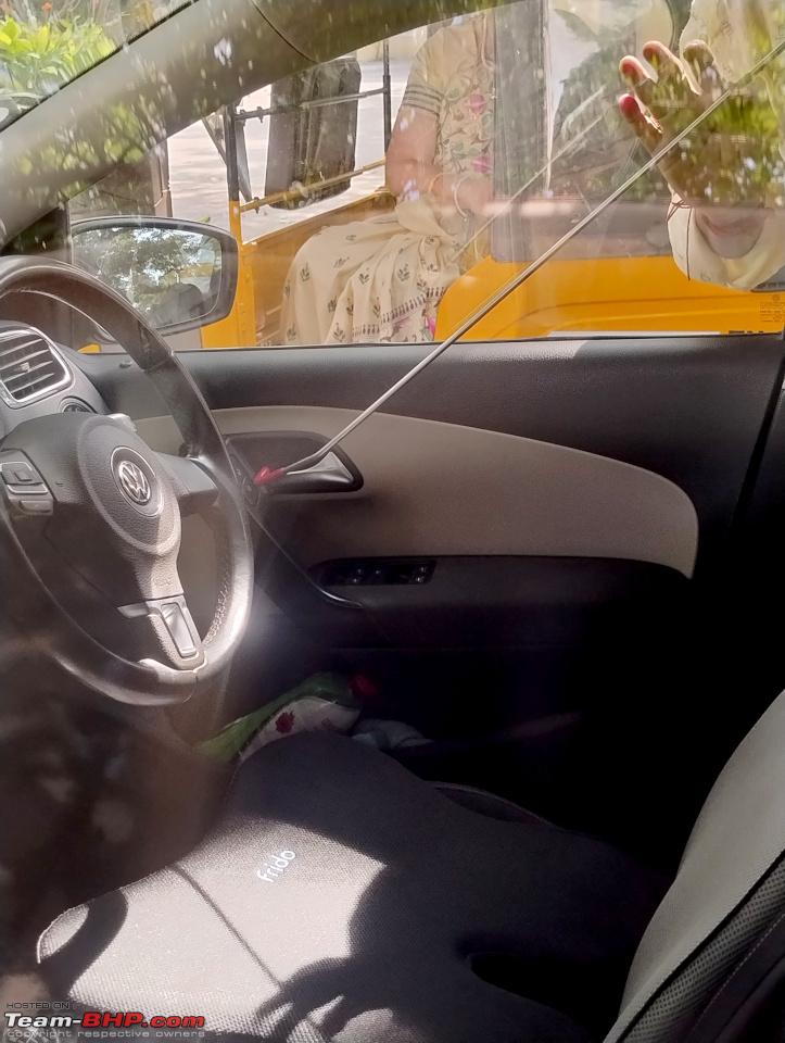

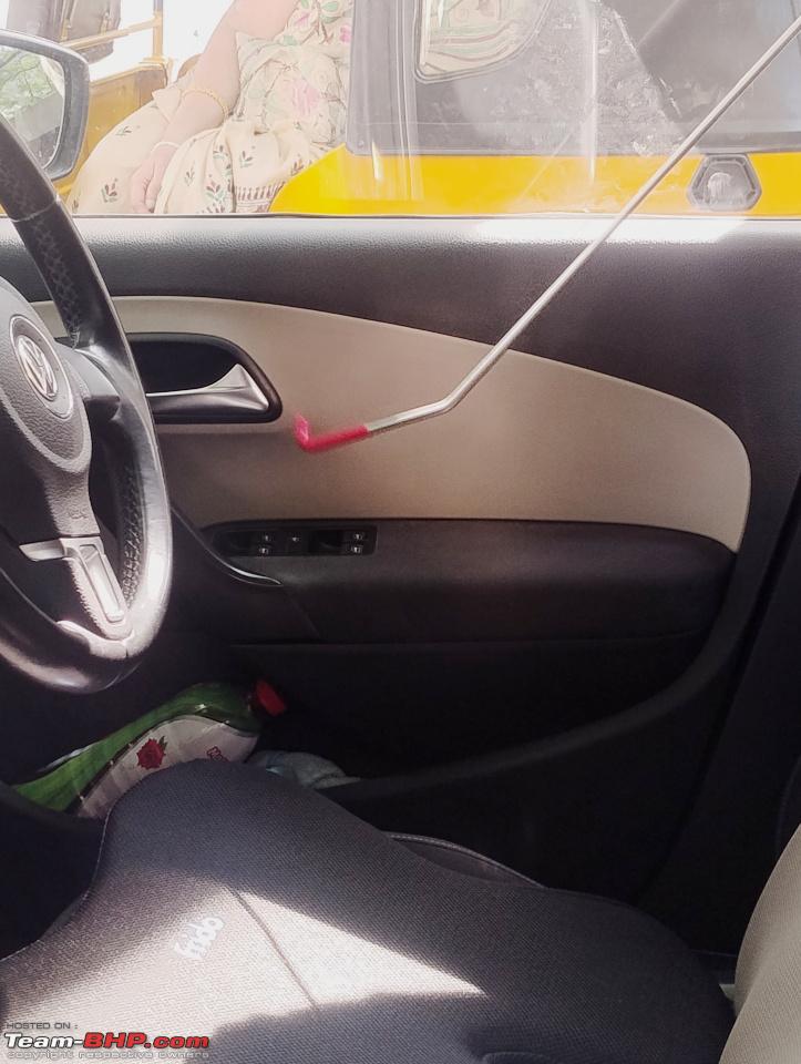

We were at a wedding, and it was all over bar the lunch. I put my camera in its bag in the boot of the car and shut it. Only to realise that I left they keys inside too.
I had used the quick-boot-unlock button: it does not unlock the doors, and the boot immediately locks again when shut.
Went back to my wife and said, "I've done something very stupid! Keys locked in car. I need to take your keys home to get the spare key." We were not far from home, it would have taken only 20 minutes round trip. But her reply shocked me: "I left my keys inside the car today."
Our FNG said he can open some cars but not mine; VW Service said they could send someone from the far north of the city. We called various people, who offered various help, but all some time away.
We called a local auto driver to go to a lock shop to see about getting into our house. We struck gold. The guy said, "I cannot open that make of house lock, but I can get into your car!"
For Chennai residents, This guy has a first-floor shop very near to Thiruvanmiyur Market: Murugan Keyshop. He says Google knows about him.
Other locksmiths/garages/car thieves (;)) may offer this service. I'd seen it done on youtube, even just using thick wire and wedges, but the magic pneumatic-bag thingie makes all the difference.

I think this is the professional way to open a locked car door under such circumstances with a inflatable bag to prevent any damage. If it was a thief or the police towing people they would not have thought twice before inserting metal scales etc under the door. Did you by any chance try to find out if those police towing vans were nearby? They would have happily obliged I suppose.
They are called Air wedges and they are used to align doors and windows for installation.
They are available in Amazon and I did pick one up since I accidently locked the car with the keys inside one time and the locksmith caused dents on the door frame trying to insert a long metal rod between the doorframe and the roof to hit the door open button on the door pad.
Yes I think so too. To get the initial small gap to insert the cushion, he used plastic wedges.
In this instance, he arrived with a zipped pouch containing the inflatable wedge, a couple of plastic wedges, and a multi-piece "fishing" rod. I think it had been sold for this purpose.
A neat thing to own (Might even want to align a door one day!) but knowing me, I'd keep it in the car! rl:
Or, more probably, in the house. And, that day uniquely, my wife had left her house keys in the car :Frustrati. Otherwise, the situation would have been fixed with just a 20-minute auto journey.
