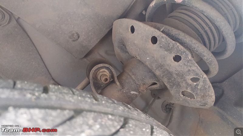

Looking at the condition of the suspension, I'm guessing it's the main grouse in addition to my height and seating position at the back.
Notice how one of the struts has started cracking slowly.
Thanks for all the inputs everyone, hope this thread helps others as well.
