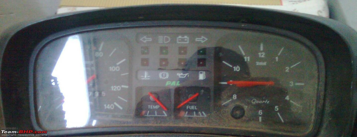

• 1993 AC with the LED cum clock console, wiper and headlight stalks like the Maruti, velvet seats, additional lights plus AC
The first one was rejected at first sight, the second looked too good but the engine sounded weird, while the third was the one I felt worth examining as a good option.
The driver there was kind enough to drive me around and then allowed me to take a test drive too without verifying if I was a bonafide driver. The car drove well.

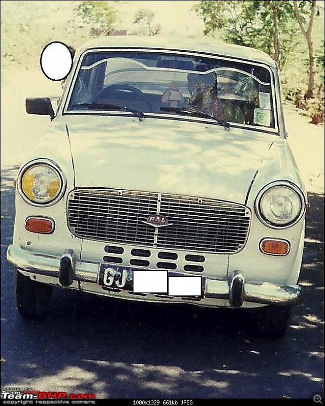

1. Installed an aftermarket ORVM on the right door(refer the picture below)
1993 Premier Padmini - Ownership Experience & Flood Restoration-frontview.jpg

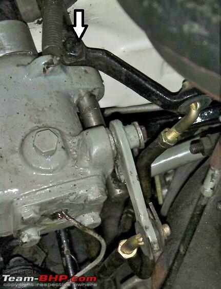

9. The gear linkage bushes were replaced – I had to go under the car to do this. Also, the vertical play in the gear lever was rectified by tightening the nut shown in the picture. The bushes with washers and split pins cost just Rs.60.
1993 Premier Padmini - Ownership Experience & Flood Restoration-gearshifterlinkage.jpg

o. Opened the instrument console, cleaned it with IPA, and used the opportunity to see why the clock wasn’t working. There was a break in the clock circuit. That was fixed using a jump-over wire. This circuit board wasn’t the insulated green type.
1993 Premier Padmini - Ownership Experience & Flood Restoration-padmini_instrumentcluster.jpg

Surprises in the six months post flood restoration
1. The starter solenoid engaged one day with the engine in operation; has to rush out, disconnect the battery, and then replace the solenoid, If I had delayed in disconnecting the battery, the starter would have run engaged with the engine and would have burnt out
1993 Premier Padmini - Ownership Experience & Flood Restoration-padmini_startersolenoid.jpg
2. Another day, the car stalled in traffic and wouldn’t start; I knew this must be something to do with the carb. Pushed the car to one side, opened the carb top, and found the barrel full of muck. Cleaned, fitted and was back on the road in 15 minutes. This car is that easy to work on.

Some more pics of the car
1993 Premier Padmini - Ownership Experience & Flood Restoration-padmini_6.jpg
1993 Premier Padmini - Ownership Experience & Flood Restoration-padmini_7.jpg
1993 Premier Padmini - Ownership Experience & Flood Restoration-padmini_1.jpg
