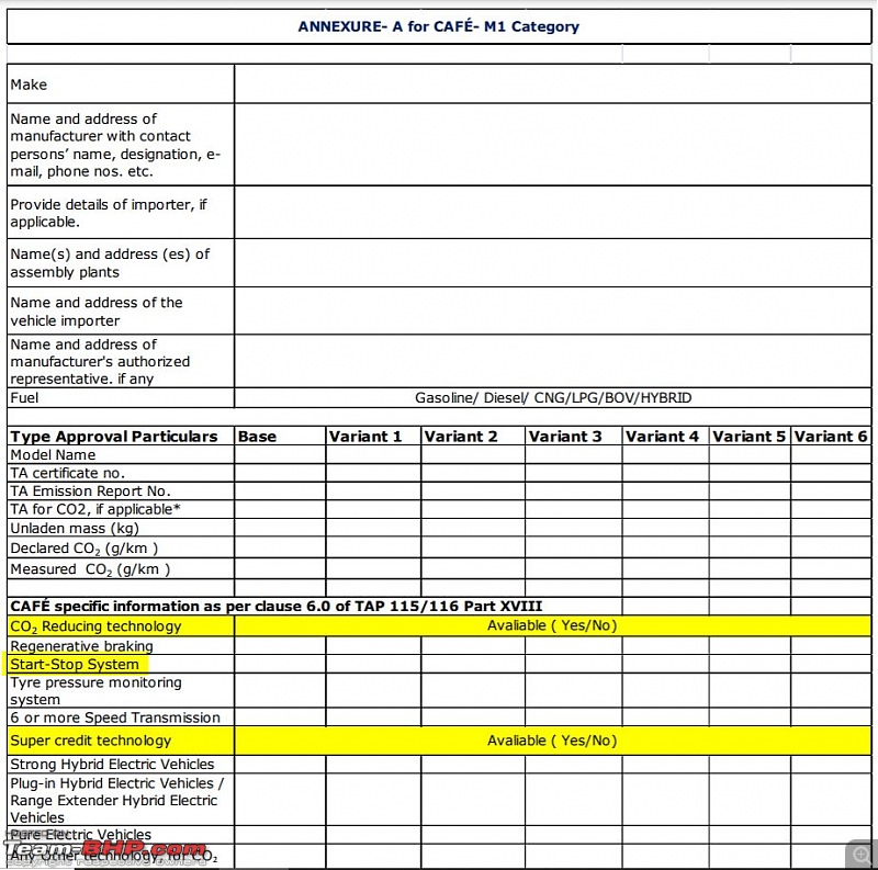

I am not a right person to comment on turbo systems, but have some experience in designing start stop system. So let me put my opinion and a couple of questions here.
The main reason for turbo damage seems to be due to oil starvation but it doesn't happen in one instance if the duration is less. When the turbo is starved of the lubrication for longer time or frequently the failure can be expected and the starvation of oil at higher RPMs will be more severe due to higher heat generation. When it comes to start stop system, as many said before the system waits for a couple of seconds (3-5 seconds typically) after you shift to neutral and vehicle speed is zero. By this time the turbo RPM would have been reduced and also ensuring oil flow for few seconds. So there should be no problem according to me.
Originally Posted by shancz View Post
I also wonder about the utility of this system itself. Has anyone checked how much of a difference it makes in terms of FE ?
Bigger the displacement, the benefit is more. Typically for 2 to 3.2L engines one can get ~4-5% depending on the duration and frequency of stop.
Originally Posted by railfanwithk750 View Post
The FE difference will be minimal, unless you are in b2b traffic, where it may give you one KPL extra.
The disable function is given to avoid irritating driver in bumper to bumper traffic where the vehicle keeps crawling. The system best works in planned urban environment where one gets to a traffic signal, has to wait for say 100 seconds, drives a couple of kilometers and again stops in some signal.
Originally Posted by balenoed_ View Post
The least the manufacture could have done was to have the default state of it to be in OFF position and leave it to the user's discretion to switch it ON when he needs it.
In my last service visit of Scorpio, I insisted the guys to see if they can toggle the state to "OFF by default" though the software. They were about to scratch the head as if they didn't even know what this system does. There I realized it is not going to be possible and they confirmed too in a while that it is not possible.
I have worked on Scorpio start stop system and the reason of default ON is to satisfy the requirements laid by the CAFE regulations. Manufacturer can get extra points for keeping the idle start stop function on default ON on every ignition cycle.
Turbocharged engines and the idling start / stop system-capture.jpg
It doesn't say explicitly in the attached picture, but there are testing criteria which include it.
saikarthik is offline   (13) Thanks
Thanks for that insight, I was not aware. Far from an expert, so I can only echo what I have read and what I thought made sense; Car manufacturers publish their FE figures according to standardised test and during those test the start/stop feature is on. So the FE and emission numbers are based on having it on. In many countries FE and emission numbers is part of the formal certification of a car that allows it on the roads. It can also determine things like VAT, road tax, so it is a legal requirement that the start / stop feature default position is switched on. Because if it isn’t, it does not meet the criteria under which the car was certified.
