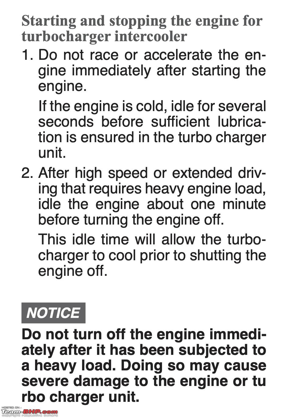

This is what the user manual of Hyundai Venue states. I'm not sure what should be called as heavy load though.

Even Ford suggests not to stop the engine immediately after a hard drive and let the engine reach the idling speed so that turbo charger doesn't have a premature wear.

No, that is not what it says: it says not to switch of the engine whilst running at high speed. And to only shut the engine down once it has reached idle speed.
The first you should not do with any engine, nowhere does it say to idle for a minute. When you park your engine and come of the throttle the engine is idling right away and according to this Ford instruction you can turn the engine off. It says wait till idle, not idle for a minute.

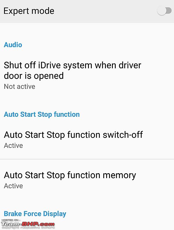

I actually tried an experiment where I kept the start/stop system on for a full tank of gas (city driving only), and found it made literally a +0.3kpl difference to the average economy when I filled up again, so I guess that lines up with the claimed of 4-5%.
In fact, I think the 12% claim's ludicrous - I'd love to see real-world evidence of start/stop providing such a massive bump in fuel economy.
The fact that the difference to the economy is so negligible, coupled with the fact that it's annoying as hell meant that the start/stop was the first thing I coded out on my F30 (which took me all of thirty seconds).
Thank god for Bimmercode.
Start stop is getting much, much better than it was.
In the new Merc CLS53 for example, the EQ Boost system (Merc's name for 48-volt mild hybrid tech) makes the start/stop so seamless you literally can't tell that it's happening.
Of course, all of this becomes completely redundant when we're all driving EVs in a few years.
Originally Posted by Turbo Head View Post
I am really curious, how you managed to shut it down permanently ?
Can it be done in BMW X4 ?
Extremely easy with the aforementioned Bimmercode app and an OBD2 adapter, takes all of thirty seconds. If you lived in Bombay I could've done it for you.
