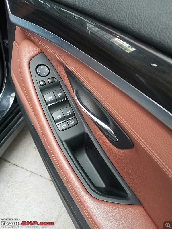

Update:
I am one of those car owners who rarely ventures out of A.S.S but I decided not to go with A.S.S this time even if they offered goodwill discount. OEM handles are poor by design and will start getting sticky all over again. I didn't realise this before but my perception that BMW materials to age poorly was mainly based on these door handles.
After checking few options, I have decided to get this done through team-bhp member @nirmaljustdoit (Keystone Enterprises, Bangalore) based on the photos he sent me of many BMW handle replacement jobs he has done. I used his detailing services in the past, so I know my car would be in safe hands. They have a team-bhp page here if anyone wants to look them up: https://www.team-bhp.com/forum/banga...bangalore.html (Exterior & Interior Detailing : Keystone Enterprises (Bangalore))
I was very keen to replace only the plastic inner-half of the handles in black colour and retain the leather outer-half. These parts were hard to source compared to the full handles and I almost gave up and decided to go with full handle replacements but Nirmal was patient enough to find the source and it was worth the wait.
Actual replacement was done at my home and took a couple of hours. They have done many such jobs as I could make out from their familiarity with all clips, screws and connections. Important thing was to achieve perfect fit and ensure everything works after the job is done - window switch, sun screen, door lock pin being flush after locking, etc. They switched off the interior lights and switched on the engine for a bit in the middle to ensure car battery doesn't get drained, etc. It's a lot of work and not worth DYI unless you enjoy working on your car. I paid Rs16.5k for parts and shipping and Rs5.5K for labour. I am very happy with the results.
Few pics of old vs new. Happy with my decision to go with black colour.
