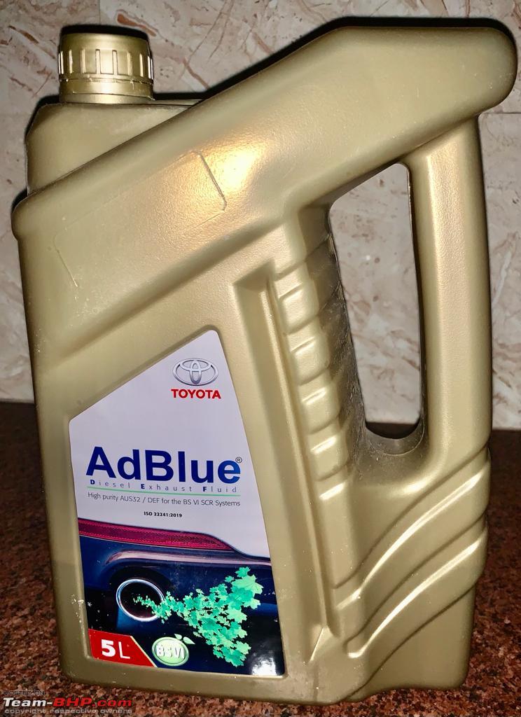

Had to fill Ad blu from Toyota dealership as I was unable to find a viable option. They have 5 litre Cans available for 449 rupees. Total fluid filled/ consumed was 8 litres for ~6500 KMS of driving. Toyota charged 960 rupees for the refill.
I think the 20 litre bucket is going to be more economical in long run. Refilling is super easy and the Can provided by Toyota has a spout and can be easily attached and used for no spill refills.
