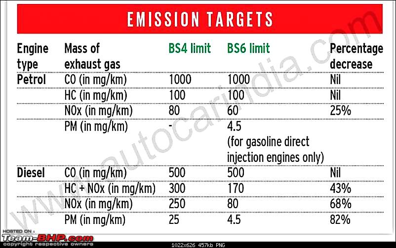

Originally Posted by anb View Post
Emissions levels of a BS6 petrol & diesel differ much. Every litre of fuel you save have more value now as fuel is very costly and diesel engine saves much more fuel than petrol engines as they are more efficient. So diesel still make some sense today.
