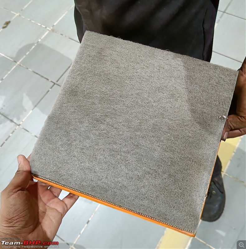

Originally Posted by sbm View Post
1)I live in Bokaro steel city which is an industrial town with the the Bokaro Steel Plant at its heart. Dense traffic is rare except in few areas which I encounter once or twice a month.
2)The roads here are pretty wide and traffic density is such that one can maintain speeds between 40- 50kmph during most of the commute to my workplace.
3) I use my car around 10 times a month to go office as we have formed a car pool and that also means that during most of this trips, there are 3-4 people in the car.
4) The office trip is 10km each way with speeds ranging 40-60kmph during the first 5kms and during the next 5kms there is a speed limit so speed has to be below 40kmph. Total trip duration is 15-20min.
5) Every month we try to take a day trip to a nearby location at a distance of 25-30km during which speeds can reach 80kmph and seldom we encounter dense traffic.
6) I also use my car for daily chores like buying grocerries etc almost everday.
7) 3-4 times an year, we visit our home town in uttar pradesh 550km from here going through 250km on NH2 and then on Bihar state highways and UP state highways.
Originally Posted by arj2695 View Post
I don't think I can activate PM as I am newbie.
This issue of Oil Dilution is higher in MT vehicles as compared to AT vehicles. One main reason for this is that lower engine speed in Idle. Whereas in AT the engine speed is comparatively higher as it is needed to run the torque-converter.
If your driving route has more idle zone (bumper to bumper traffic, leaving the vehicle idle etc.) or the average.....
Long post alert. Thanks for your indulgence.
Regarding oil dilution, as you have explained and as I also learned, it happens mainly due to the regen process. Frequently aborted regen due to short trips dumps more diesel in the engine oil.When the technicians drained engine oil from my car, they found 7 litres, i.e., 1 litre in excess. I verified from multiple sources in the Mahindra dealer network that this much mixing is permissible. In fact, Mahindra has recommended changing engine oil at 10 km instead of 20 km when driving in city conditions. So I have decided to regularly change the oil at 10K now.
Regarding DPF clogging never faced DPF clogging during 17800km and 1 year of ownership. I have described my driving pattern in the above-quoted post.
It was after this EMS flashing that I faced two warnings. Another Bhpian and two more Facebook group users have also reported the same. I took the car to the service centre yesterday, and the following happened:
1) They outright denied that it was happening due to the EMS software update. Note that this has never happened before with the same driving pattern.
2) They checked the soot mass, and it came to 10 g collected in 36km. Last time, there were 19g collected in 168km. They concluded that the car is generating excess soot, and they'll have to check the fuel system, air intake system, EGR, turbo, etc. At first I didn't allow them to take apart my car as I knew they would create more problems in the process, but later I allowed them to check the air filter, diesel filter, turbo, and throttle body. I have attached photos here. They said that the air filter and diesel filter choked, and that would also cause excessive soot generation. I agreed to change those parts as the 20K service is coming up anyway.
3) Regarding diesel quality, they said that diesel quality is fine, but it's not BS6 diesel. That is a surprise in itself, as the last refill was from my regular diesel bunk, and it has never caused any issues before. I have attached a picture of the diesel sample they took.All this time, they denied that a bad EMS configuration might be responsible for excess soot generation.Please note that the only time I had to refill at an unknown diesel pump was during my Nepal trip last month. That was two refills ago.After doing all this, they asked me to use the car to see if DPF warnings were coming now or not.
Now, my doubt in all this fiasco is:
1) Why did this all start just after EMS flashed? Everything else was the same as before, and I never faced any issues.
2) There is a possibility that Mahindra has tweaked regeneration parameters to reduce the number of aborted regeneration cycles. Even if it is so, is it normal to receive a DPF warning every 150km? I mean, the car is not even trying to perform regen during normal running and is straight away asking the user to perform it.
3) Do you think that the choked(?) air filter, diesel filter, and diesel quality might be causing excess soot generation and it might just be a coincidence and the EMS thing has nothing to do with this all?
I might be overanalyzing all this, but I can't shake this off as the car was fine until now, and I can't help but blame the software update for all this.
As I had experience working with EMS software, any modification done by OE would have been validated before using them in a customer vehicle. But, this is a possibility. Any anomaly in software could cause unexpected behavior, not limited to DPF clogging.
10g of soot accumulation within 36km is really high. Also, 19g for 168km is also high. For XUV, if you are driving in city, the soot accumulation is approximately 22-24g for every 300 or so km. As mentioned in your post, this could happen because of choked airpath. If this happens, it could lead to higher EGR flow and produce more soot. Also, if Diesel filter is choked, it could cause problem with combustion.
Not sure how they say it is not BS6 diesel. Can you ask them to get a report of the same. I am sure Research center at Mahindra has facility for inspecting Diesel quality. BS6 has been there for the past three years or so.
Now, the answer why this happened could be because of many other reasons, it could be just a coincidence that all start right after EMS software update. But we cannot rule out EMS until we can prove otherwise.
It is not normal to get DPF clogging warning every 150 km. DPF warning would only come up if the regeneration has not happen even after reaching the maximum soot limit.
As they have replaced the filters, please keep an eye on how the vehicle performs. If it is still performing the same, then software might be the culprit. But, it would be hard to make service team believe it. Please do escalate to higher MnM team.
arj2695 is offline
