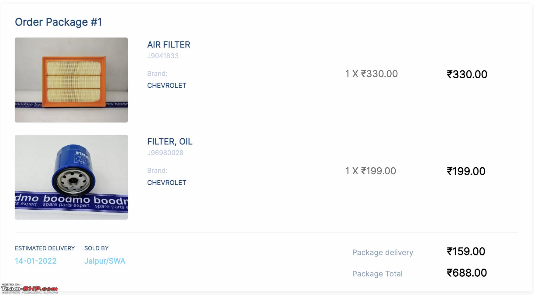

Cost of Spares Image
Disappointing service experience with Automovill | Finally got my car serviced by a local mechanic-screenshot-20220109-5.31.42-pm.png

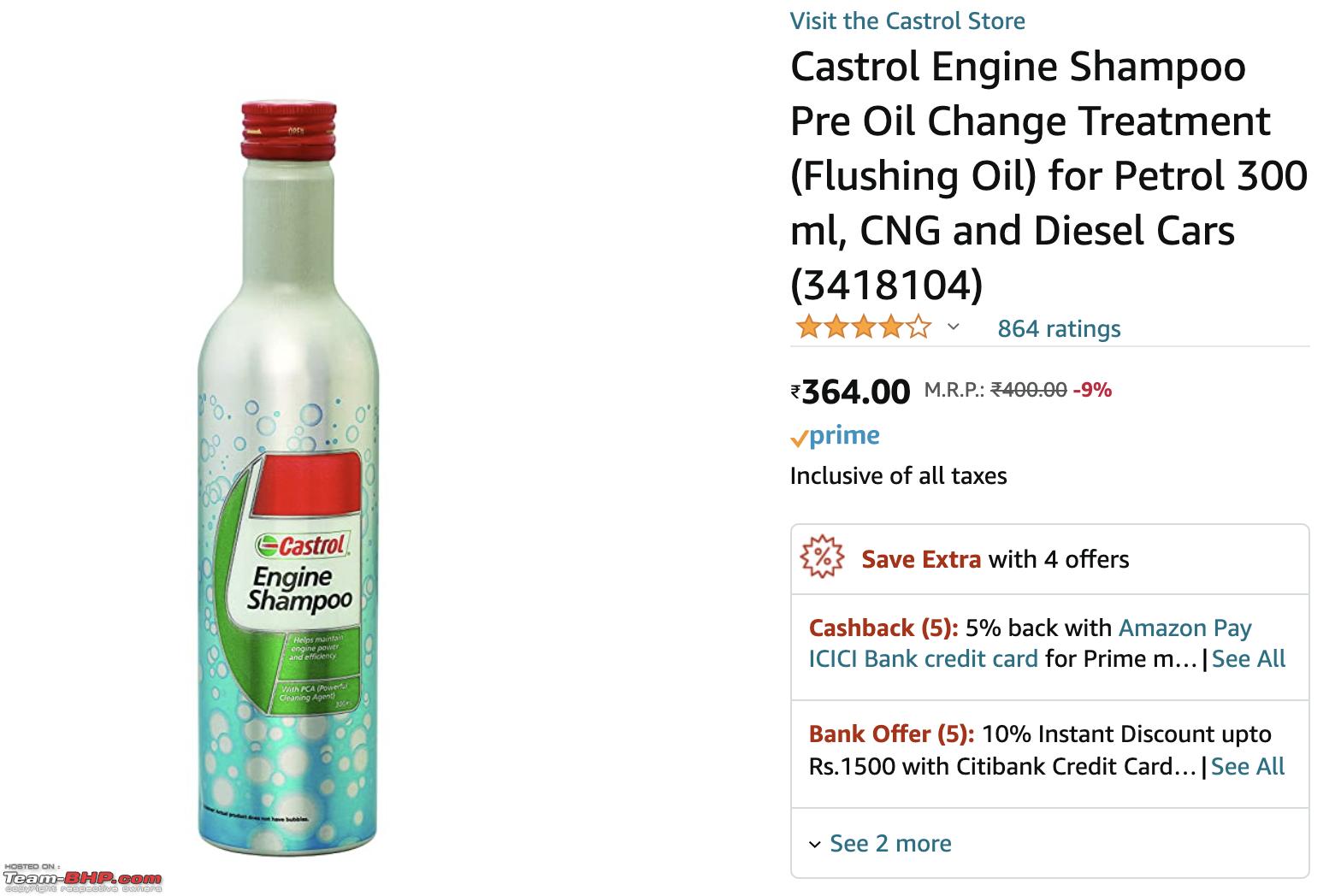

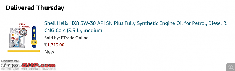

Cost of Engine of oil from Amazon
Disappointing service experience with Automovill | Finally got my car serviced by a local mechanic-screenshot-20220109-8.41.46-pm.png
Cost of Engine Flush from Amazon
So the total cost of spares is (Airfilter, Oil Filter, Engine Oil) - INR 2,765 (688+1713+364)

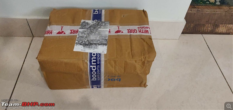

It took 7 days for the parts to arrive:
Disappointing service experience with Automovill | Finally got my car serviced by a local mechanic-whatsapp-image-20220109-10.09.08-pm-4.jpeg
package from boodmo

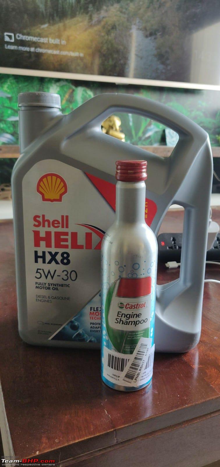

Disappointing service experience with Automovill | Finally got my car serviced by a local mechanic-whatsapp-image-20220109-10.09.08-pm-3.jpeg
Disappointing service experience with Automovill | Finally got my car serviced by a local mechanic-whatsapp-image-20220109-10.09.08-pm-2.jpeg
package from amazon
Also, I ordered Castrol engine shampoo to flush the engine, it cost me another 364
Now it was time for action:
Disappointing service experience with Automovill | Finally got my car serviced by a local mechanic-whatsapp-image-20220109-10.11.19-pm.jpeg
It took about 90mintes of my investment and INR 450 to get the job done to my level of satisfaction
