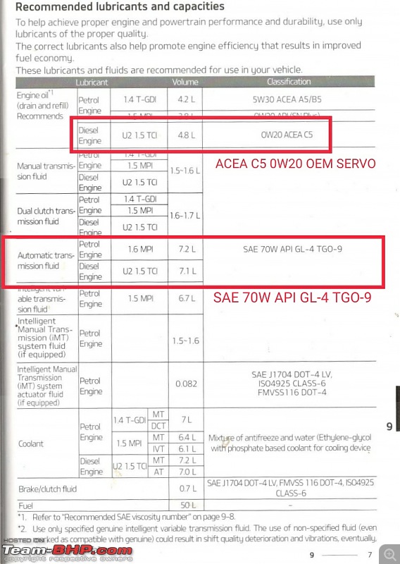

What is the ATF spec for the 6-Speed AT boxes of recent Hyundai cars such as the Nextgen Verna & Creta manufactured from the year 2017 second half?[/b]
I have a Kia Seltos Diesel Automatic & the manual says ATF is SAE 70W API GL-4 TGO-9 Grade
Infact this grade is standard across all seltos variants, petrol or diesel, manual or auto, even iMT
Any idea if ATF SAE 70W API GL-4 TGO-9 grade is easily available in India
Attaching the owners manual screenshot too
Why you should periodically change your Automatic Transmission Fluid (even if "sealed for life")-527e4a14a89e447aa5cde0e692c78021.jpeg
