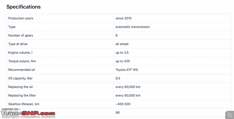

For those with Aisin 6 speeds in Toyotas (Fortuner, Innova) and Mahindras (Scorpio N)
Information is form the following link:
https://gearboxlist.com/toyota/ac60f/
gives those of you who would like to change the ATF, the oil specifications.
The transmission model number is: AC60E (2WD) or AC60F (4WD)
I believe the right fluid specification for this TC is: JWS 3324 (WS)

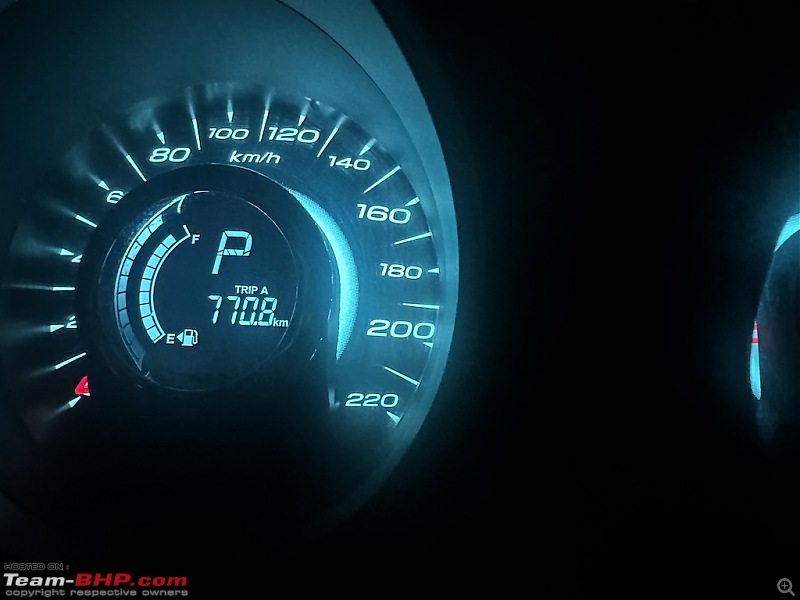

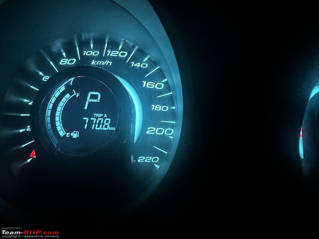

At the service centre, the AT error did not appear. However, I faced the issue again after driving more than 50 km. After reading this thread, it became clear to me that the transmission oil was recirculating improperly, making it too risky to continue driving the car with the old ATF fluid.
I insisted that the service centre replace the ATF fluid and clean the ATF cooler before returning the car. Initially, they were hesitant to do so — partly due to the cost (around ₹10,000) and also because they did not have the full quantity of ATF fluid in stock.
Still, after my persistence, the team at AMPL OMR agreed to change the ATF fluid and clean the ATF cooler. To be fair, they did a terrific job with both the fluid change and the ATF system cleaning.
Here's what I observed after the oil change:
a. Gear shifts are now super smooth — almost imperceptible.
b. I took the car for a drive of around 800 km across various conditions (previously, the issue occurred during the shift from 3rd to 4th gear), and the car performed flawlessly. (Picture attached)

My recommendation:
For anyone driving a Mahindra/Aisin AT vehicle with a ‘sealed for life’ gearbox — please note, it is not truly sealed for life under Indian driving conditions. Once your extended warranty ends, get the ATF fluid changed. (Mine was 8 years old.) It may be costly, but it's worth it — as an AT replacement could cost upwards of ₹3.5 lakhs.
The ‘sealed for life’ concept simply does not work in Indian conditions.
