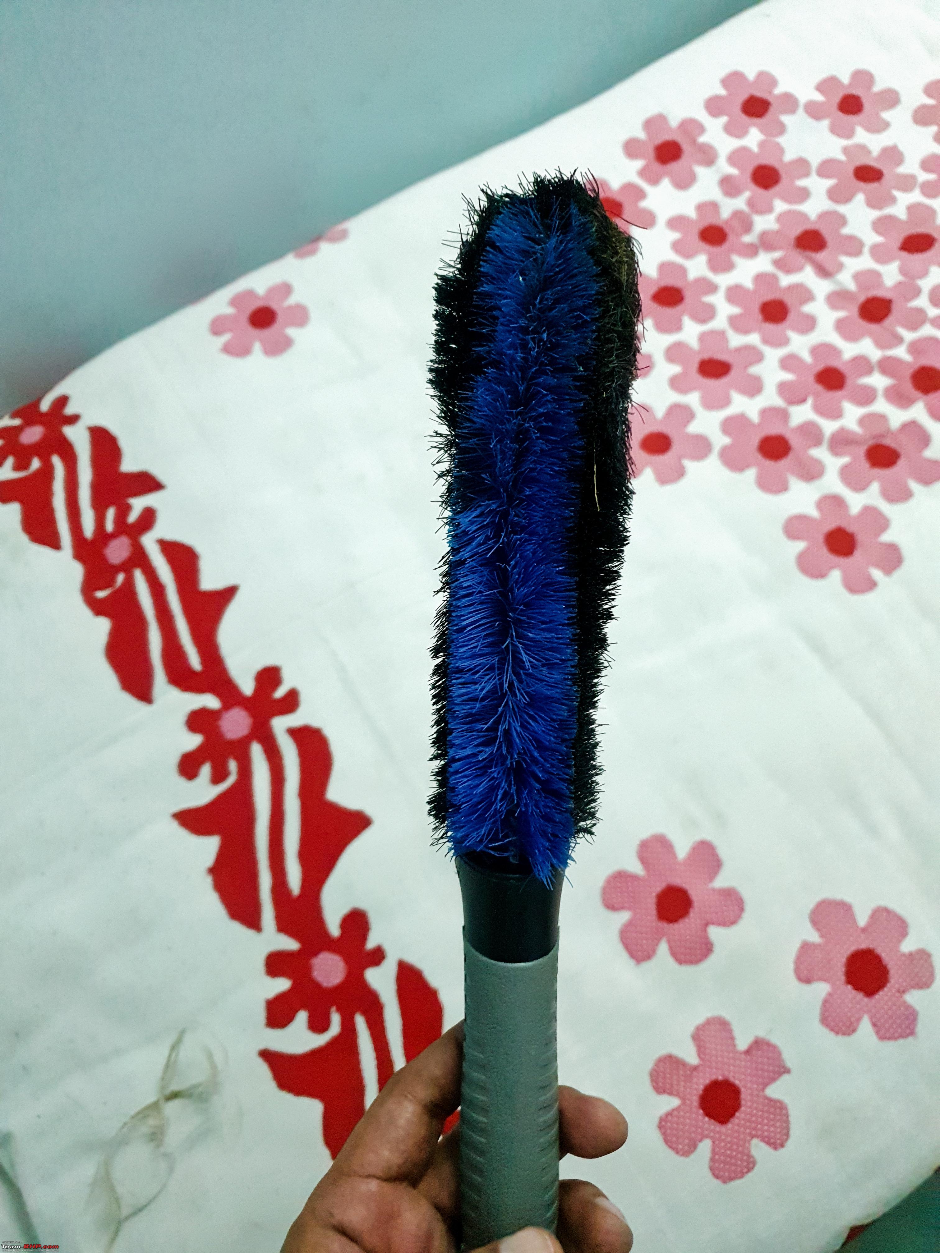

While i agree that cleaning the engine bay should not be a daily affair but again the detailer in yourself takes over and one has to clean the bay.
What i usally follow is spray the bay with 1:10 APC and then i use the the long handle brush which has bristles through and through and use it to scrub the engine bay thoroughly.Good part is since the brush has a decent length you can go scrub deep in the engine bay.Post that i use a manual sprayer and spray the engine bay .Post that dry the bay with a mf towel.
As far as the service centers are concerned i once visited a 3M centre for washing and this guy did a perfect job of cleaning the bay.

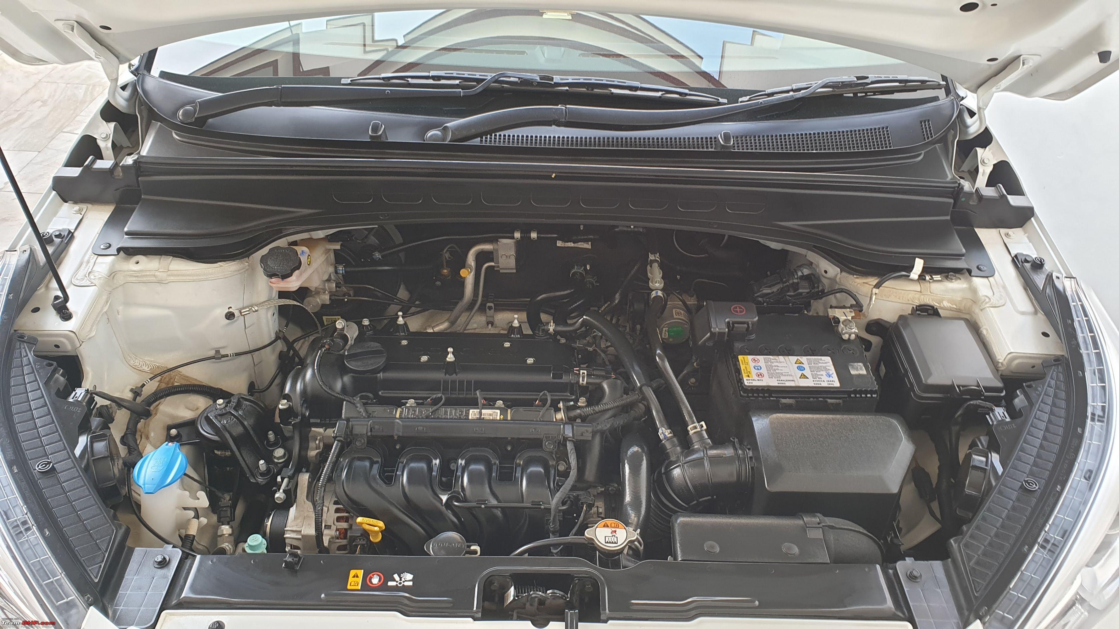

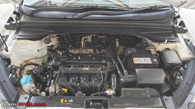

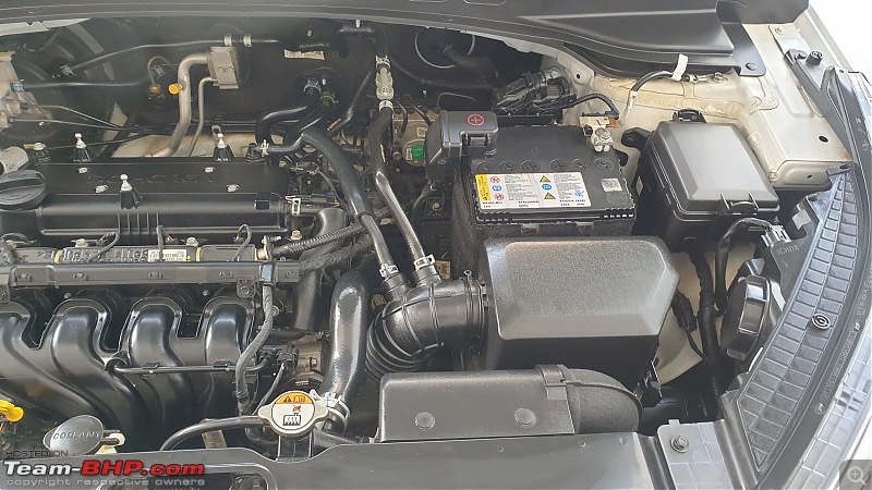

Inspired by the posts did a Engine detailing session followed by a Waterless Wash.
Followed the below steps:-
1.Sprayed the bay with APC(Bilt Hamber Sufex HD 1:20)
2.After waiting for 10 minutes used a long handle brush to agitae the surface as best i could.
3.Using a manual sprayer sprayed the bay with water .
4.Used a MF towel and dried as much water and kept the bonet open for 2-3 hours to let the bay dry.
4.Used Carpro Perl (1:2) and sprayed the engine bay again followed by cleaning with a MF towel.

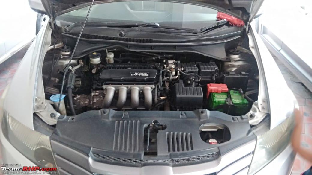

I just blow off the dust using a dry cloth first, then wipe the engine bay using a damp cloth. I do it once a month or twice. Engine bay looks clean and no leaves left on top of cowl which is prone to rust.
I clean my car and rarely give it to water wash.

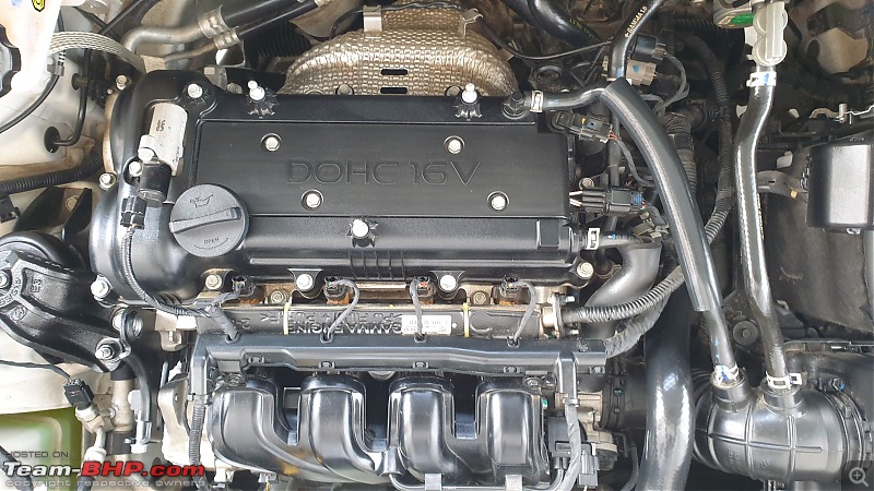

Old 3rd April 2022, 01:32   #60
Join Date: Oct 2021
Posts: 124
Thanked: 167 Times
re: How to Clean the Engine Bay?
I had not cleaned the engine bay in ages! Did it during this Dussehra during the car wash session. Used a garden hose to wash down the engine bay followed by a degreaser + dishwash liquid application along with a brush.
Before:
Attachment 2075733
After:
Attachment 2075734
Not clean by Leoshashi standards but this will do.
Hey Gannu,

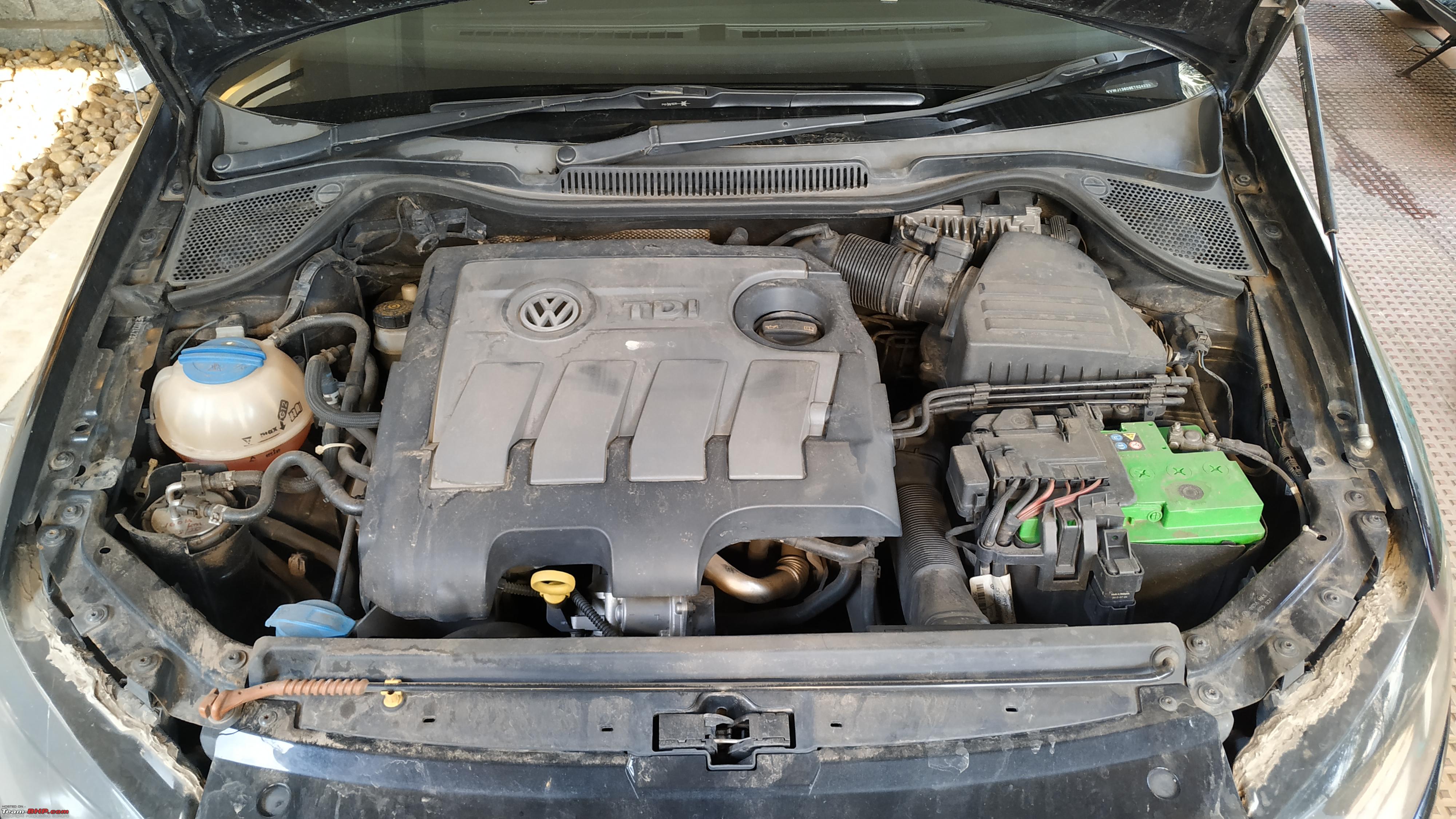

Some careless car washing guy used solid pressure washer for engine cleaning. My heart dropped but don't know why I didn't stop him. Later on I asked him to dry it ASAP using a cloth with light hands.
Would there be any repercussions ? It's a VW Polo TSI HLP manual, 2021 model..car started fine after all that but I am really worried
