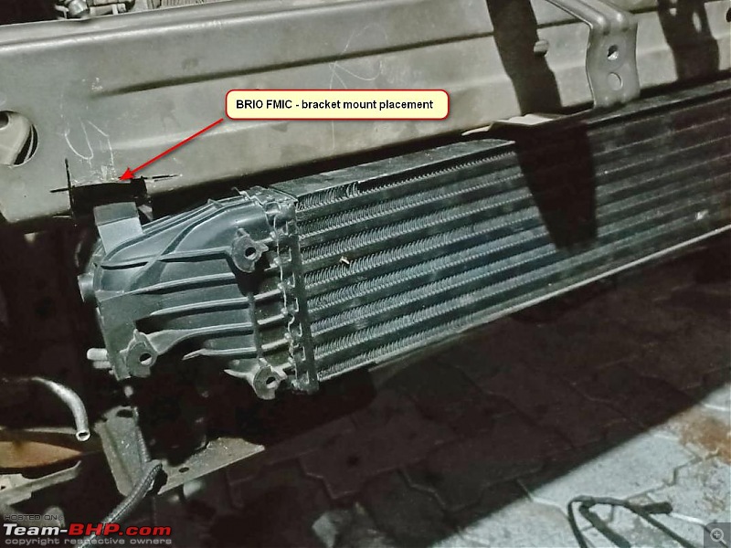

Intercooler selection -
Selection is mainly based on the application and budget. Getting a HUGE intercooler capable of supporting 1000hp may be detrimental to performance on a 300hp application. The smaller the IC volume, the quicker it fills. A huge IC takes much longer to fill. Ideally, an intercooler should be sized to how many lbs/min the turbocharger can flow. End tanks also play a very important role to direct air flow. Air doesn’t like to go around corners. Air slows down in IC with bigger cross section and speeds up when the cross section is small. Front mounted IC is straight forward good option but often adds other challenges like additional intercooling plumbing (volume), modifications required for routing.
My search for intercooler took a fair amount of time. Started from taking exact measurements of available space for intercooler installation to checking various websites and going to auto stores godowns looking for suitable IC. Finally found a Mahle brand intercooler of the right size that was near perfect for my application.

Most of the plumbing was done with stainless steel pipes and OEM intercooler hoses from different makes. Based my intercooler plumbing pipe diameter based on my Compressor outlet diameter. Had to upsize my turbo plumbing for the IC pipe going out from the intercooler to the throttle body for it match the size of TB. I got all the pipes, clamps and hoses locally. Some of them were custom machined though.
Turbine outlet is a V band type and since I did not find a suitable V band clamp, we machined one that could do the job well. Not the best looking V band clamp though.
The length of the intercooler was just right, it starts and ends at the exact window size as my bumper lower grill. Had to make a small cut and weld onto the metal frame behind the bumper to get the intercooler fastened firmly and securely.
A whole lot of time and effort is going into how to do the plumbing to make it appear almost like a stock car. Most of the plumbing will not be quickly visible when you look into the engine bay. I think I may even loose a little power in the quest to make the plumbing least visible and retain stock like engine bay looks. For those of you thinking about building your own FMIC setup, by all means go for it.
Here's some pics of the IC pipes installed on the car. Most of these pics are taken late in the evening with my old phone.

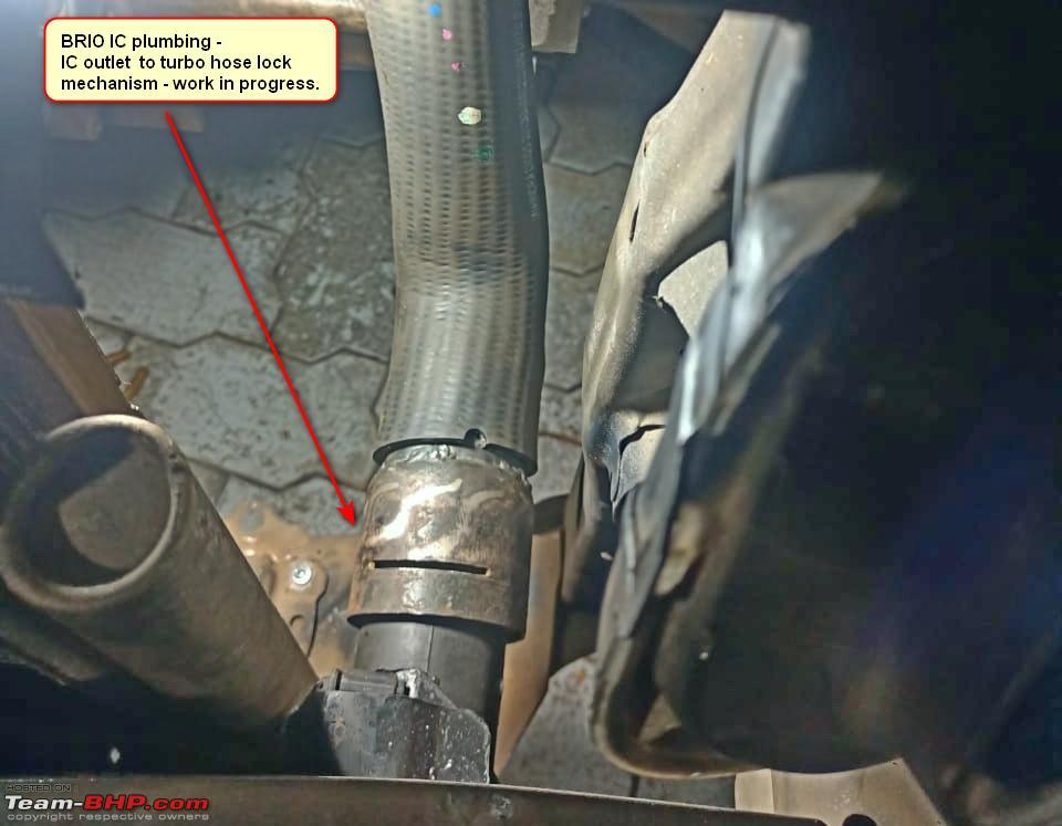

Brio Intercooler plumbing / routing -
The routing on this BRIO intercooler piping is perhaps as stealth as it can be. Some of the plumbing uses miscellaneous OEM turbo hoses at interconnects and custom interconnect lock mechanism. This also has provisions to have fastners / brackets to keep the pipe supported and rigid.
