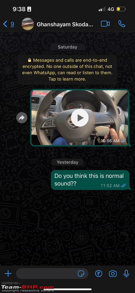

Hi Forum members,
I recently did my third service from Aryaveer Skoda, Moti Nagar. Apart from regular servicing, I made them aware of certain noises coming from rough roads and from somewhere inside the steering column. The car has done just 33K KMS.
I asked them multiple times what the ETA was and why the noise was coming from the car. After the road test, the advisor informed me, it's all normal and there is NO NOISE. I hesitantly agreed to that and asked the car to be serviced. Now lies the issue that bothered me about the technical knowledge the guys at ASC have.
I chose to wait till the service from 9 AM to 3 PM. At 3 PM, when my car was getting lined up for the wash, I asked the advisor to bill me. Came the surprise. He said, we did another test, and the suspension mount needs to be changed/greased. Man, they could have well told me that in advance and I could have left for my home, instead of waiting for the car to be worked upon for suspension issues at the last hour.
Nevertheless, I asked them to change the mounts and drop the vehicle at my home.
Now, coming to the most interesting part, whenever I turn my steering from left to right and vice versa, a peculiar knocking sound comes. The intensity reduces when the car is in motion, but it is very irritating whenever the car is stationary.
I asked the service advisor to pick up my car after two days, which they did and returned the car to me in the evening after a full day. You may ask, what was the issue and what solution is given? The solution given is:
THIS IS PRESENT IN ALL SKODA RAPID. We cant do anything with respect to this. WOW.
Now, I asked around a few Rapid owners all of them denied having this sound in their cars. I visited a well-known FNG who suspects a steering rack issue. I called the service advisor, Mr Ghanshyam and told him about the feedback from FNG. He simply ignored all my protests. Said, they don't believe anyone who is not from ASC. And when I asked him what the solution he has for my issue, to which he replied: " If you are not satisfied, can't do anything. You can visit any ASC but we can't help you. SORRY No reply to chat and video that I sent.
I am simply appalled by the attitude of ASC. Is this where SKODA INDIA is heading after Zac Hollis left?
Please listen to the sound in the video below and please share what can be the issue. Is this a steering rack or column issue?
Steering Noise in Skoda Rapid | Skoda ASC says its normal-whatsapp-image-20221219-9.39.08-pm.jpeg
