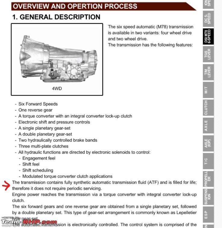

I see this against right to repair. Basically, the so called "Sealed for life" is relative term. I did some digging and the results are surprising.
See the service manual (DSI M78 6 Speed AT) page A:
It says that the gearbox ATF is sealed for life.
Attachment 2393357
In the same service manual, page B states Oil Change Schedule:
Attachment 2393358
Now what I understand is "Sealed for Life" is a marketing term. These companies assume that an average Joe would run is car for about 30,000KMs in this life time.
This is completely rubbish!
Another point to note is that many would not drive 30K in warranty period. So the manufacturer would want the gearbox to fail post warranty so more mulah can be milked. This treand is very unethical.
We should raise voice against this. All manufacturers should term the "Sealed For Life" in terms of KMs or Years or better both.
As I have said, changing the Oil is like replacing 30% bad/burnt ATF with 30% new. Proper way is to change at 30K and flush at 70K. No two ways about it.
