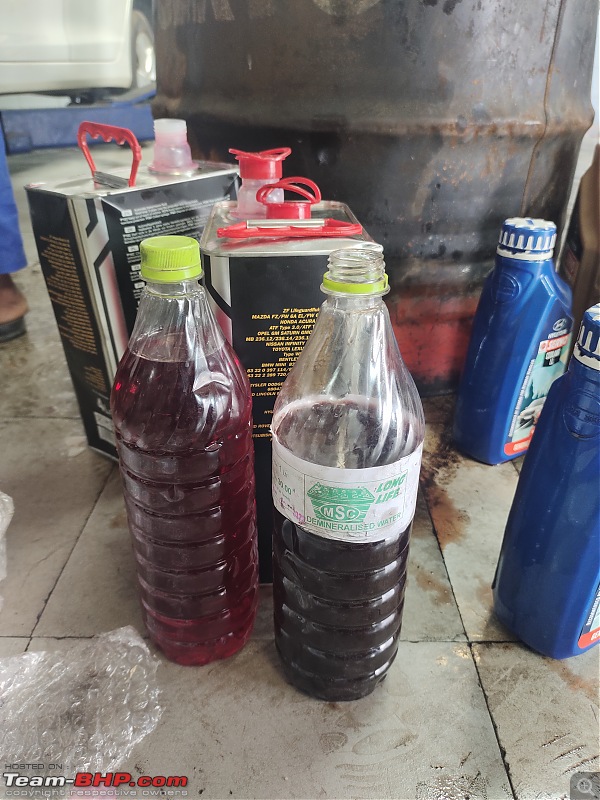

Try amazon.in. I have changed my Elantra 1.8 ATF at 1.18L kms with Manol SP4 ATF. Make sure you use SP4 grade for your Verna as well.
Apparently, the hyundai service personnel have no clue regarding ATF replacement. I had to specifically tell them to get it changed in my car.
Why it's important to change the transmission fluid of your Torque-Converter AT-img_20221030_131427.jpg
Here you can see the difference in colour of ATF, left side being the new and right hand side being old ATF.
