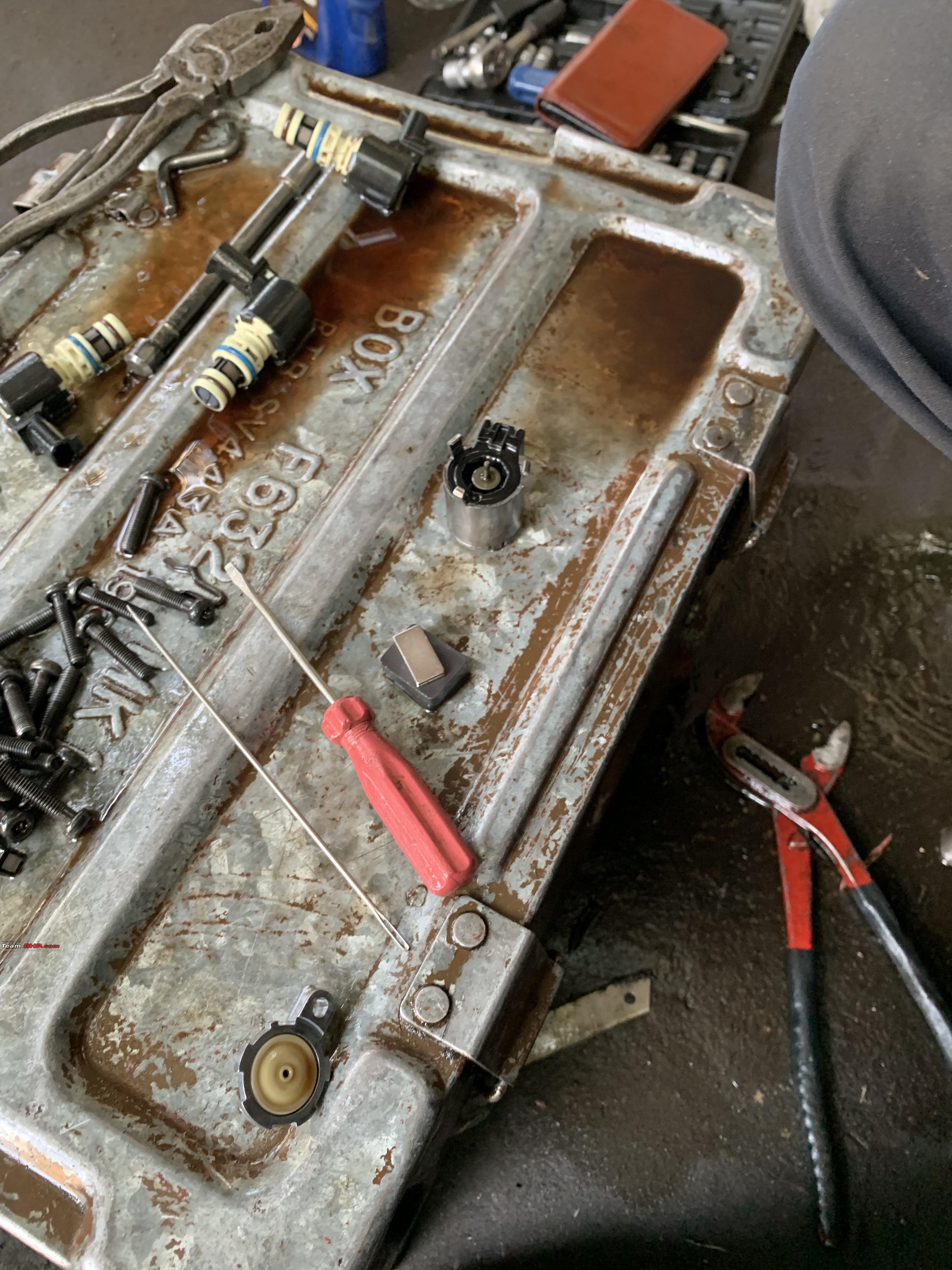

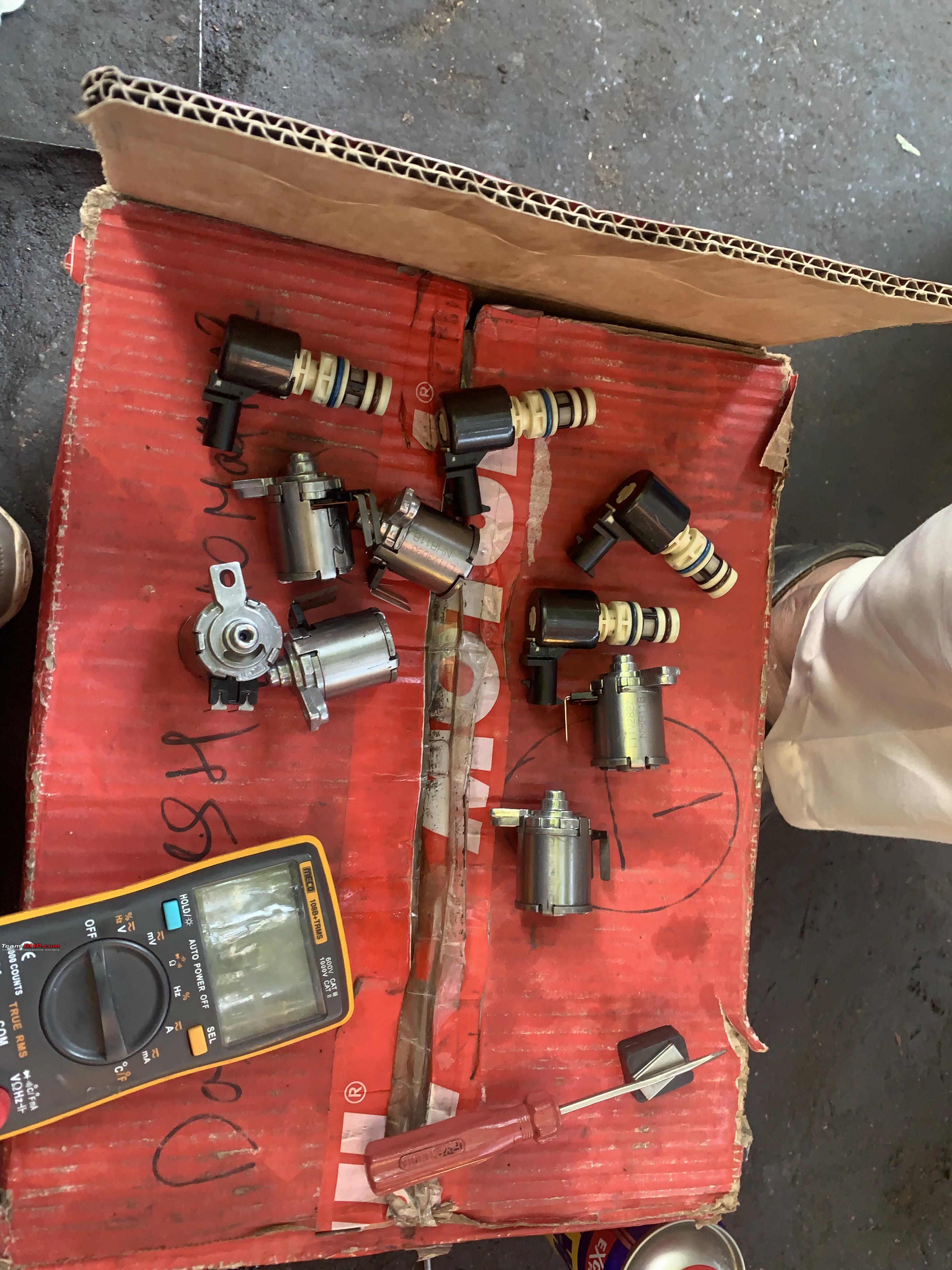

I got my 6 speed AT valvebody serviced due to stuck solenoids, which was due to Mahindra not flushing ATF in any of the service schedule.
Mahindra asked me 4L for full AT box replacement. I got serviced under 30K.
Round ones are variable pressure solenoids. Long ones are sift solenoids.

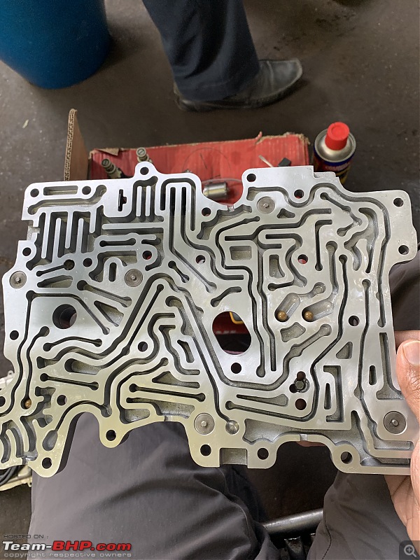

Opened up valve body with scary one way valve bearings open and ready to fall.
Why it's important to change the transmission fluid of your Torque-Converter AT-598e3eeccf904237b0df615bb2c4bac7.jpeg
As Mahindra does not provide child parts, the stuck solenoid opened up for further investigation.
Why it's important to change the transmission fluid of your Torque-Converter AT-43694b04aa6e427ca4c2a7c307551058.jpeg
Cleaned and assembled valve body ready to go back into transmission.

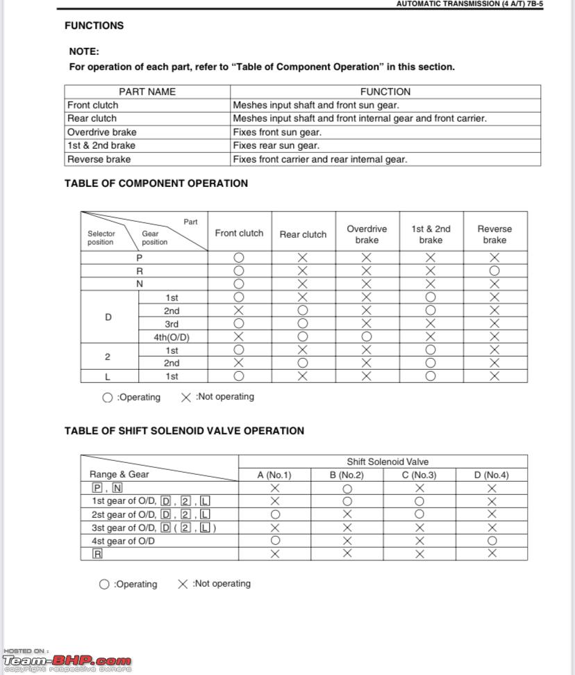

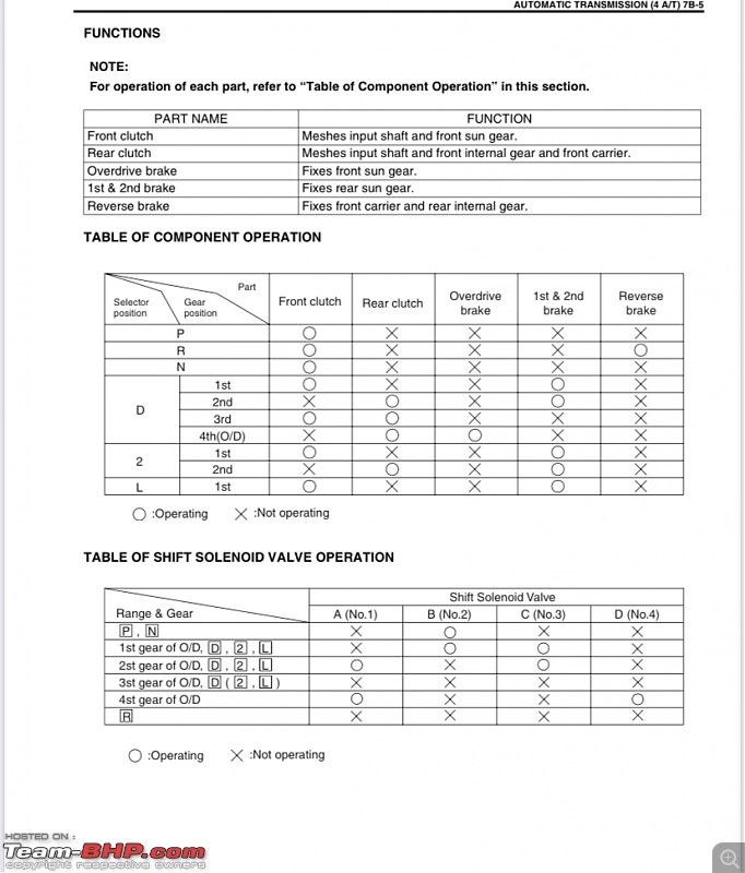

My point is the simpler the gearbox, the less chance of it to fail. Mine got stuck at 1.10Lakh km. Many would not even touch half the kms so they would be fine. But in my case, I see reliability as paramount.
On other hand, the Suzuki has only 4 shift solenoids.
