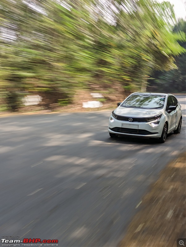

A few Motion shots that really capture her beauty!

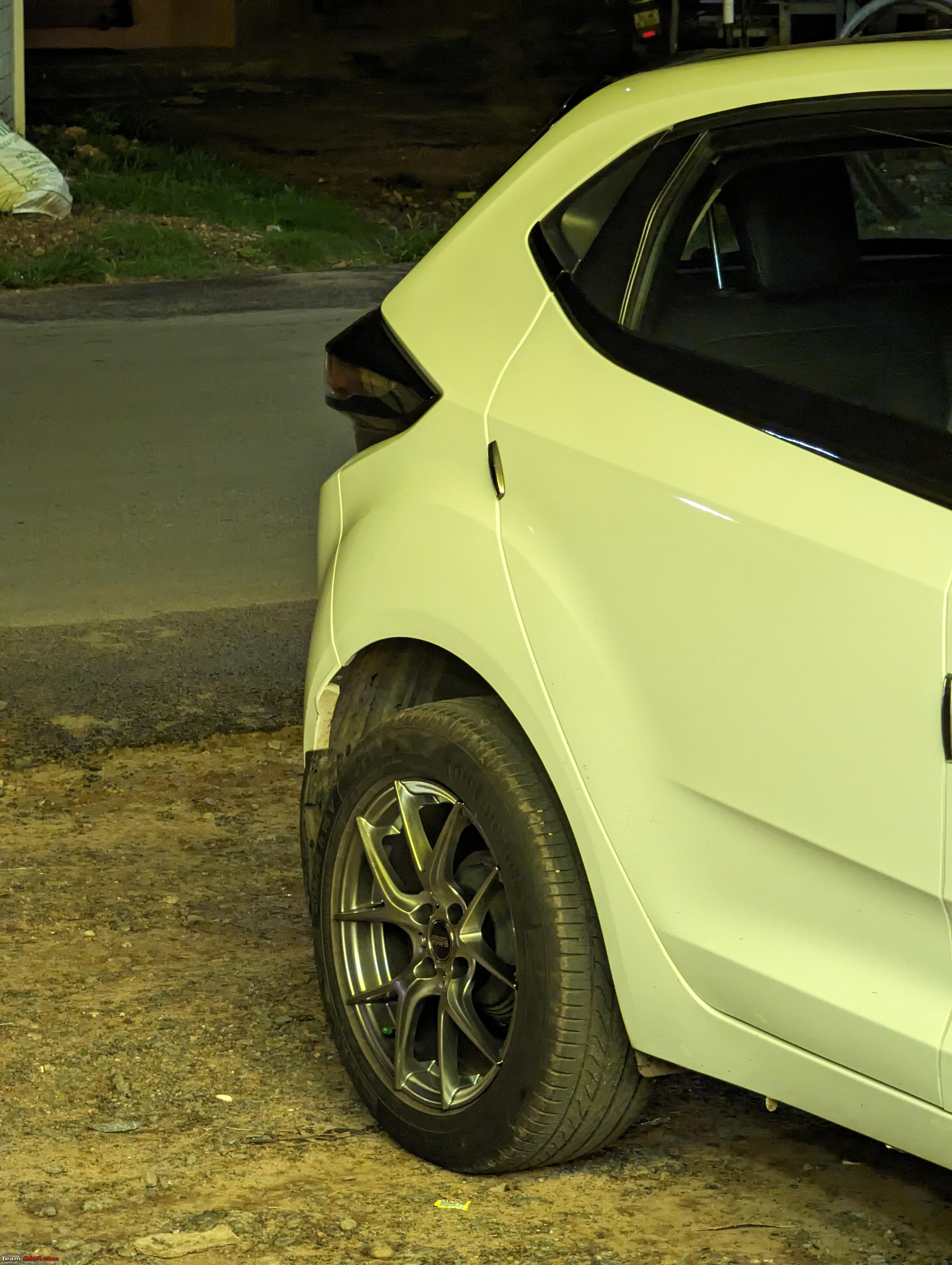

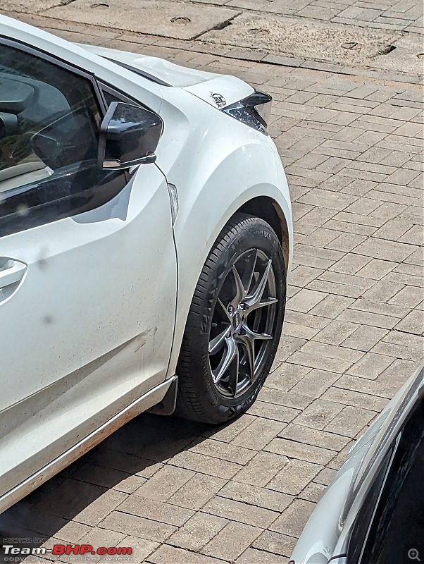

Some chill pics (candids?) with the new rims!

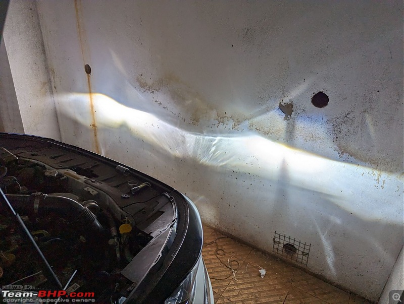

Here are the images!
These photo was clicked with the LED in the left projector and the HID in the right one. You can clearly see how well the HID's beams spreads as compared to the LED spread.
Although in the road, the brightness of the HID doesn't seem as bright as the LED.

I think you should swap the lights to something else, maybe retrofit a proper LED projector for good measure rather than this set up. In the interim you may revert to stock with Philips halogen bulbs of 55 \60 W.
Remember good OEM LED lighting is only around 20W or so, so 130W LED aftermarket bulbs are probably talking about power consumption of all of them in a shipping box.

From the images it looks like the beam pattern is not correct, bright spots, dark spots, spread etc. Whatever mods you do should be better than stock, not just in terms of brightness but the other criteria as well else your eyes will focus on the wrong parts of the road and miss something important.
