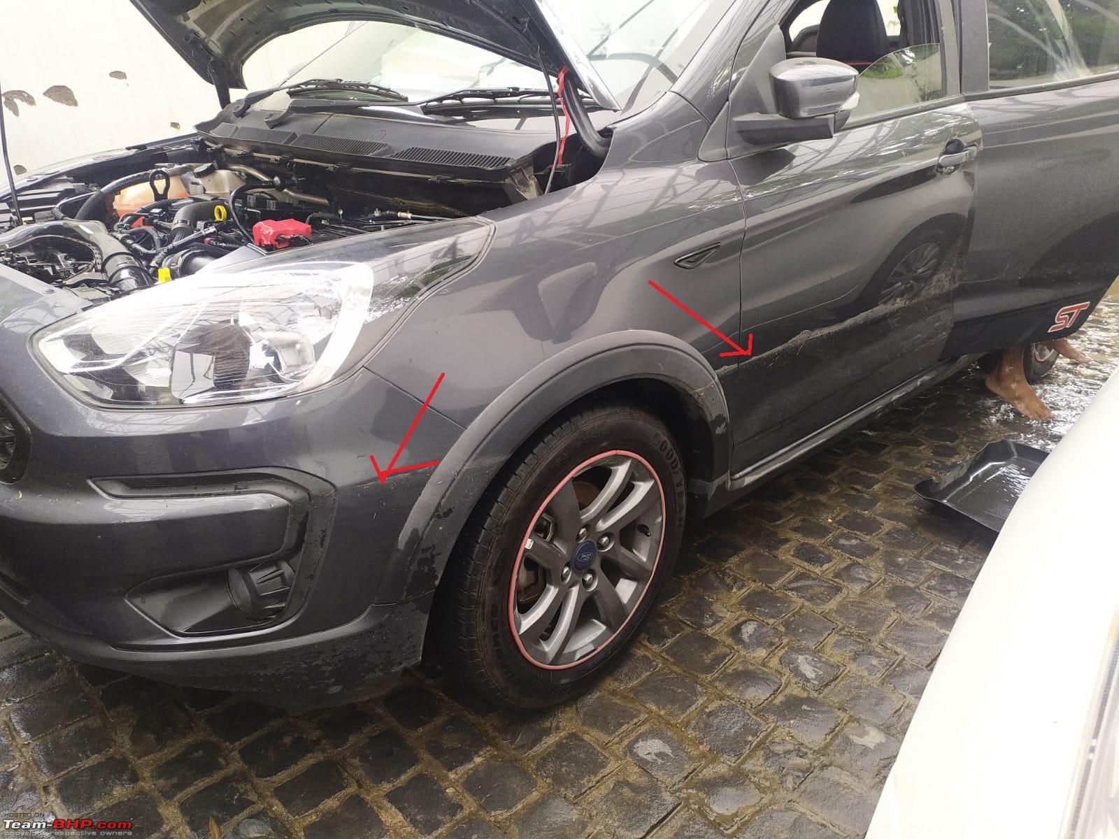

My Ford freestyle 1.2 Petrol was left in my office basement and was unfortunately stuck in tyre level flood water for 18 hours. Gave the car to ford ASC for thorough checkup and interior cleaning. After inspection, ASC says airbag module which is fitted near floor has conked off due to short circuit and requires replacement. They do not have the part in stock so I will be without any functional airbag for next few weeks.
Before I take delivery of the car and place order for replacement parts, wanted to confirm my doubt here. Car has numerous fuses to protect components from short circuit right? Is it possible that some fuses might have blown up?
