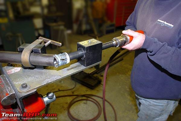

That tube notcher setup is quite "ghetto", but i like it - simple!

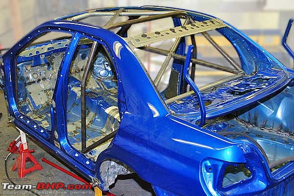

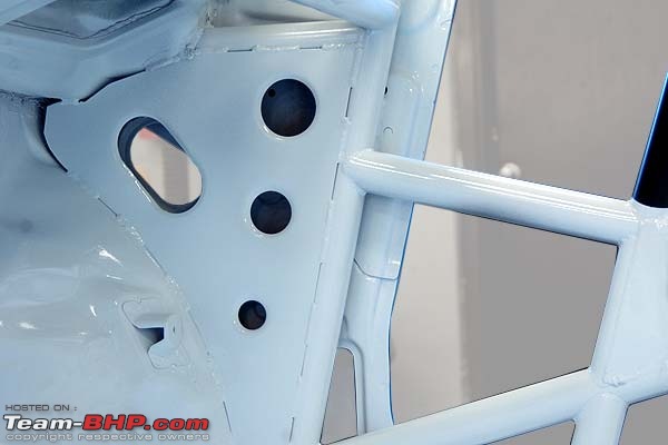

The amount reinforcement done to the chassis I don't think it will flex a bit.

wat is the overall weight of such rollcage!!

amazing pics.. many many thanks for sharing. The roll cage looks like a web, the driver in there should feel really safe.
