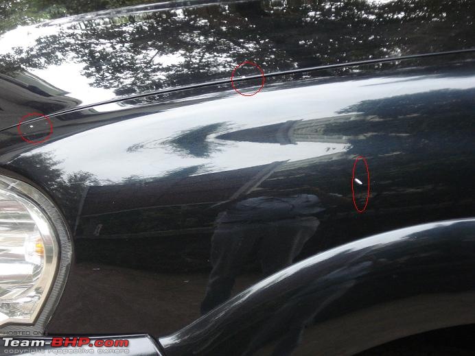

Few months back I went to attend my cousins house warming function in a WIP construction society.
As per the instructions of the security guard I parked the vehicle. By the time I returned I see all the white marks on the car. Initially I thought they are white wash marks. But I realised these are white paint marks.
I tried using Diesel to clean the marks, but it is of no use. In one of the visits to the TASS, the service person said he will get them removed with the help of 3M guys. They used turpentine and it became mess. You can see the smudged paint marks in the first photograph. Fortunately they stopped after trying one mark itself.
The Tata Safari 2.2L Technical / Problems Thread-paint-marks-1.jpg
The Tata Safari 2.2L Technical / Problems Thread-paint-marks-2.jpg
The Tata Safari 2.2L Technical / Problems Thread-paint-marks-3.jpg
I got the waxing and polishing done from the 3M, but they are still there.
Can the expert suggest how to get rid of these marks?please:
KVS
not sure, but you can try nail polish remover. Let us know if that works
KVS
Hey!! so it happened with you too.
I too got same type of paint marks when my house was in the process of painting.
I tried every kind of rubbing to get rid of them but at last the simplest method worked.
"One day i tried to remove it by scraping with my nails and to my fortune, the paint mark was removed without any type of scratches, It was after that it took me some 1/2 hour only to get rid of those paint marks.clap:"
If its an external paint you can try paint thinner to remove it. I had the same issue some time back. Just bought paint thinner (easily available in every paint/hardware shop).
Take little thinner on a small piece of cloth, rub the affected area. Immediately clean with a dry cloth. DO NOT RUB HARD, a gentle swipe will be enough, as if you are wiping a mirror.
Just be careful with its use, it feel cool if you touch it, but will give burning sensation on prolonged exposure. Best is wear a glove (also available in the same shop).
Let me know if it works. If you in Bangalore, I can give you a demo ;) I have some thinner left from the last time :)
Thanks
Ravi
