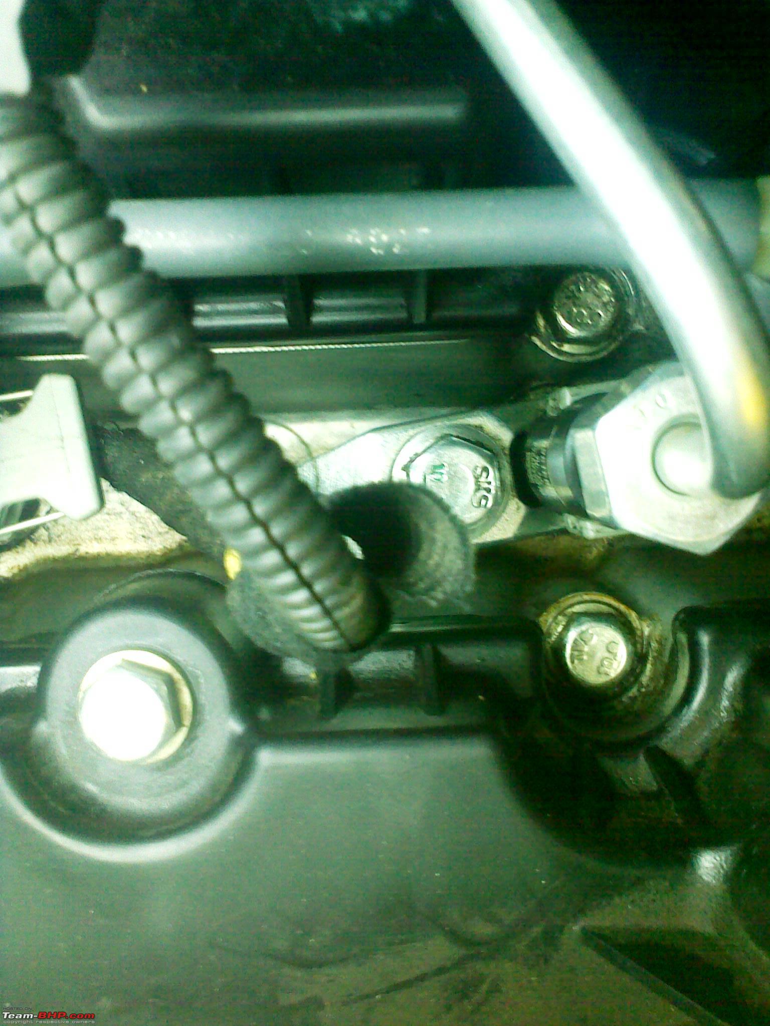

Originally Posted by dadu (Post 1630148)
@rahul76, Your earlier pictures do look like diesel spillage marks burnt over time, but its nothing to worry about, there's a lot of heat under the hood and with time the grime builds up.
Heres the latest pic of the area, after thorough cleaning. Hoping that its nothing more now to worry about.

and a negative of the same :D I am amazed... it gives lots of further infomration. Dirts are easily identifiable when you look at both the pics carefully and match the pattern in negative. ofcourse its how i interpreted it..
You have become a cleanliness freak, Best of luck. :thumbs up
Ah no Dadu...not freak It was just because, wanted to take no chances of oil leakage from there as per instructions from TASS and guys back at RC. Those pics above were b,coz of just playing with irfanview and came across negative option :D
